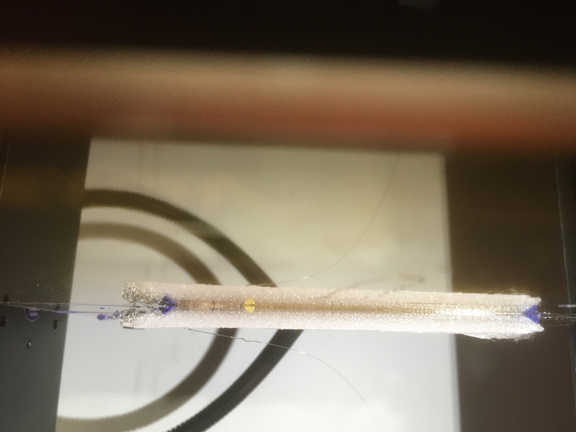

I tried to print the same part as before, and got the same (badly shifted in X) result. This was with PETG, 60% cooling fan at layer 5 & up, extrusion percentage at 100% (it was at 115% for the first try). I'm using the latest version of S3D for slicing.
This part has a curved bottom supported by PLA support material, and it appears that one side of the curved bottom was flexing upward a bit on each layer pass. As the main extruder head moved off the table to make room for the support extruder, I could hear a loud 'stutter' for a second or so as it passed the end of the part (the place where the material was slightly raised). I now suspect that the X-axis stepper motor is torquing out and stalling for several steps as this happens, making the step count off. The X-axis error accumulates for each layer where the primary extruder has to move off the table, and by the time the support layers are done, the accumulated error produces the X-axis shift seen in the previous photos. This would also explain the 'protruding lip' on the side with the rounded end (opposite the vertical connector piece). As the X-axis error accumulates, the print slowly moves to the right, layer by layer.
Here's a photo of the second try, cancelled shortly after the support layers were finished when I realized the same X-shift was present.
It can be hard to tell which way is 'up' in this photo due to the mirroring effect of the kapton tape layer, so make sure you are looking at the photo with the big overhang on the right side, with the near edge of the table (brown/orange bar) at the bottom.
Assuming my theory about this is correct, I'm a bit amazed that S3D doesn't raise the primary head (i.e. lower the table) before moving it off the table. Is there something I can do in S3D to make this happen?
Thoughts?
Frank
Thoughts?
Frank

I ran another experiment where I turned the model 90 degrees in S3D to (I thought) avoid the stepper motor stall problem. Unfortunately all that happened is to change the X-shift to a Y-shift!
I guess the good news is that I'm now pretty sure it is caused by the nozzle dragging on the slightly upturned ends of the previous few layers. I was actually able to watch it do this a few times, and I could hear the 'stutter' as the stepper motor slipped steps (or at least I think that's what is happening).
Meanwhile, my Prusa MK3S is happily printing all of these parts with no problem, with the same filament
Frank
Frank
