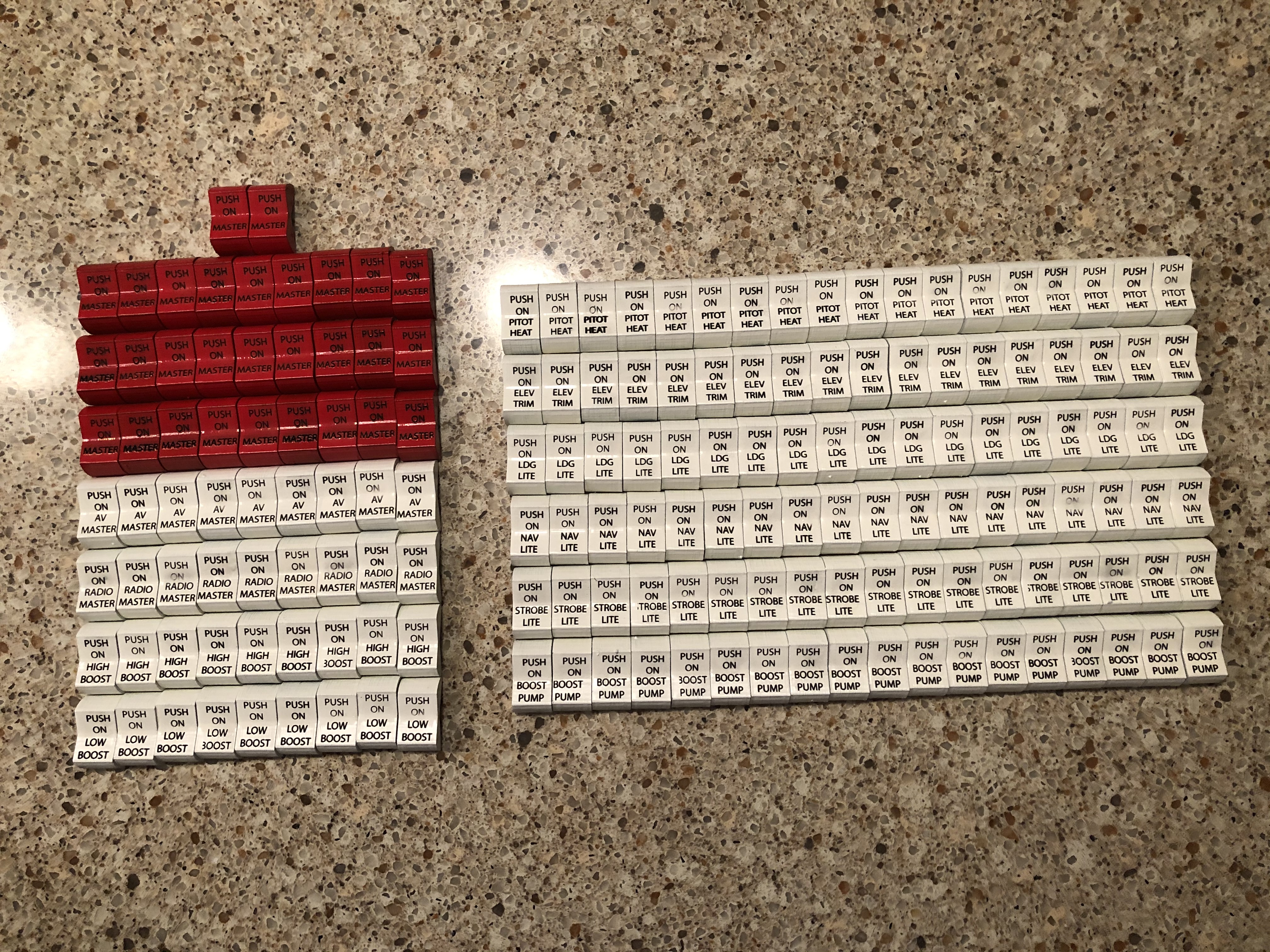

Post by Phil » Wed Dec 02, 2020 5:20 pm
These are switch covers for Mooney aircraft. I use ABS, acetone-based spray paint, and a 50W laser engraver. Someone here, (I do not remember who), suggested the paint-ABS combination. The paint REALLY sticks well.
