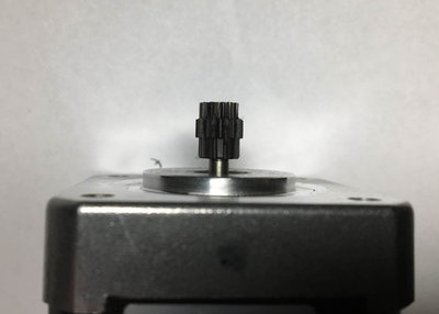

I must have a different version my pinons look different :lol: (J/K thats after four years of use.)

sthone wrote: ↑
Tue Aug 21, 2018 5:20 pm
The driving section on the end looks well-used: you're in line for a new motor, too!
Re: Can anyone recommend a 3rd party pinion replacement?
Post by sthone » Tue Aug 21, 2018 9:27 pm
Yeah it pretty much ran out of usable surface. I did end up buying a whole new motor already but also bought another pinion too just to use this one as a back up in a pinch if one of my other printers suffers the same fate.
