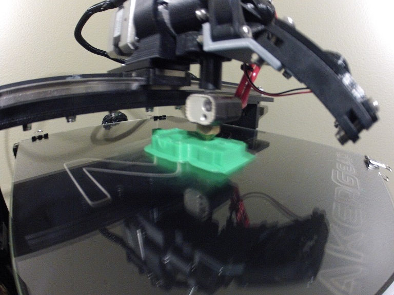

I'm late to the game here. But I want to comment that I made that V6 extruder mount in gray PET+ from MadeSolid, and it came out perfectly and worked like a charm. The main problem was that MakerGear introduced the dual extruder for beta testing just days after I printed it, so it got extremely limited use and is now mainly collecting dust! The dovetail did require a bit of sanding down until I could get the cover to fit over it with some hope of getting it back off again. I printed without a raft but with plenty of support, and printed at around 70% fill (can't remember the exact value). The rounded edges on the bottom do tend to cause the edges to warp upward a bit, but my print recovered after a few layers. The support is critical for PET+, which (for me, at least) is a complete disaster on overhangs. It does not bridge well across open air like PLA does.
