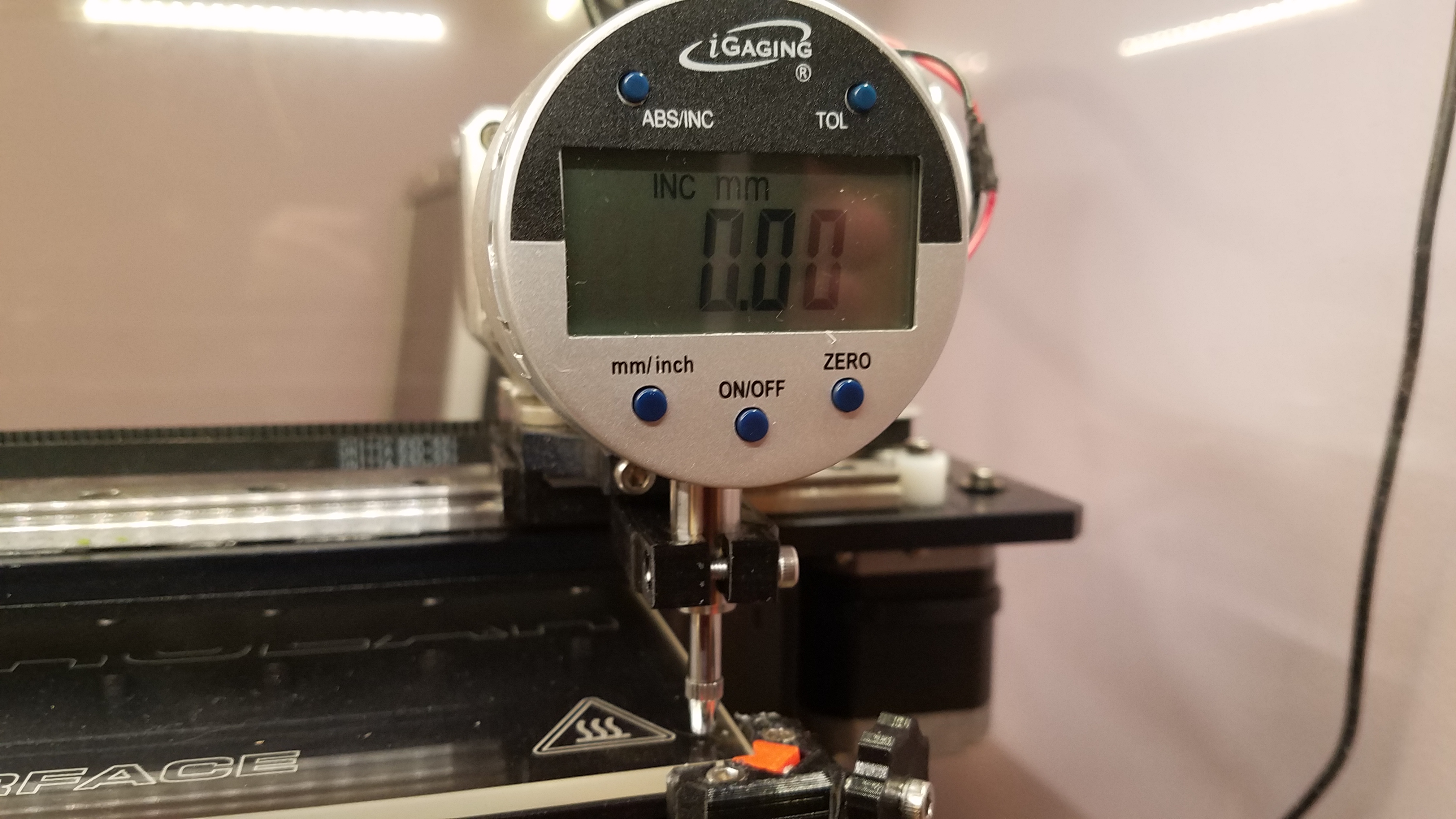

My gantry was slightly bowed so I made a mount that slides up into the extruder mount once it and the cooling fan are removed. The mount holds a DI with the return spring removed so the pin rides on the build plate without pressure. Then you run the gcode and write down the reading. Takes a bit of time but you can get the bed as level as physically possible. This will also let you shim the X rail, I used aluminum foil folded as many times as needed to get the desired thickness.

I used the DI to level the bed by taking measurements at the corners and adjusting the screws so the the bed was level there. The gantry sag due to belt tension so the ends are not going to be out much. The problem with the sage is you set your starting height in the center then it is way to high on the sides..
After the bed was level on all 4 corners, I used a gcode file that moved the DI in a grid over the entire bed stopping for 10 seconds at each spot for me to write down the Plus or minus amount from the corner zero. Looking at the readings it was obvious that there was a sag in the gantry or at least that is how it measured. After shimming the bearing rail with aluminum foil stacked to the needed height, there was no longer a sag in the center and if I recall, there was no more than .03mm difference within all the spots I measured. My glass does droop on the far left side in the center but at the ends of the plate there was no more than .01mm deviation from left to right I have not checked it lately as there hasn't been any issues with prints not sticking near the edge as there was before.
