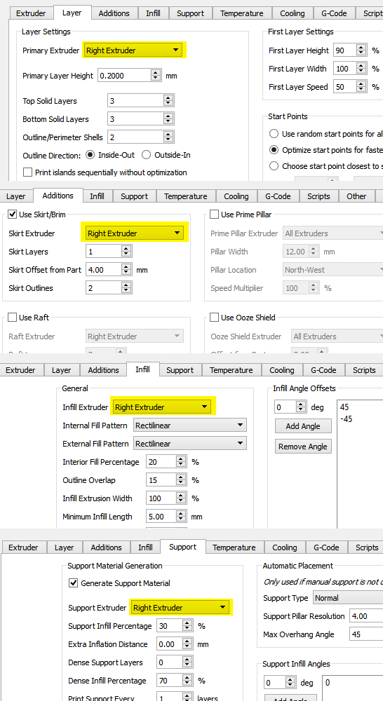

b. When you print the calibration square from the right nozzle, you need to tell the printer to use that nozzle on the pages below:
Changes to make in the Advanced settings of S3D when printing from the right nozzle.

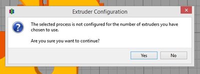

Note: When you send a "non-dual" model to be sliced with one of these Support profiles, S3D might give you the error message below. Just ignore it and continue, the profile will still slice correctly.
Just click YES and get on down the road.
Error message.JPG (18.75 KiB) Viewed 108837 times

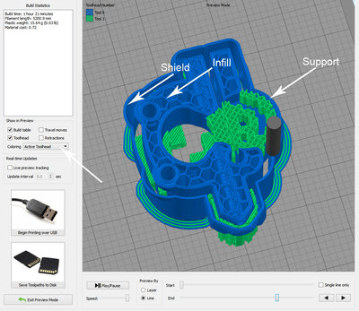

To check one of the mis-labeled files to see if it has sliced correctly.....Once it's sliced, click on the box next to Coloring, and choose Active Toolhead. That should show the left nozzle (Tool 0) part of the print in blue, and the right nozzle (Tool 1) part of the print in green. If you have your primary print filament in the left nozzle (PETG), and the support filament in the right nozzle (PVA), you will be able to see by the colors whether the main print, infill and shield are blue, with the support filament only showing green in the support areas and a bit in the skirt. That's what you want. If a Support profile sliced correctly, the shield is going to be the color of your primary print nozzle. (Obviously if your primary print filament is coming out of the right nozzle, the shield is going to be green.)
The image below demonstrates the concept. (Not too hard once you get used to looking for it.) And you only need to do this for Support profiles due to the S3D bug, it's not necessary for the other kinds of profiles.
Checking the Slice Job
Check Slice Job.jpg (62.85 KiB) Viewed 108837 times

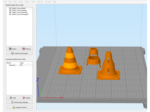

Dual Color Profiles for the M2 V4 Rev. E
These profiles work for printing 2 colors of the same filament.
Files designed to use this method have been created with separate parts that merge together into a whole.
Download the profiles and unzip.
To use the Dual Color profiles, import the unzipped FFF file into S3D.
Import the two separate parts of the bi-color file that you want to print:
Example:
Traffic Cone http://www.thingiverse.com/thing:21773

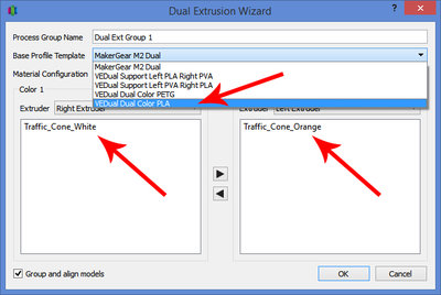

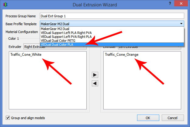

Click on Tools > Dual Extrusion Wizard.
Select the Dual Color Profile in the drop-down for the Base Profile.
Choose the Dual Color Profile you wish to use.
Choose which color you wish to assign to each extruder.

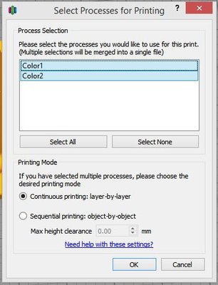

When you get ready to Prepare to Print, choose both the color profiles shown.
Slice the print by selecting both Color Profiles.
Prepare to Print 1.JPG (33.37 KiB) Viewed 108833 times
These profiles print with both a brim and a shield, and both colors of filament are used in each.
