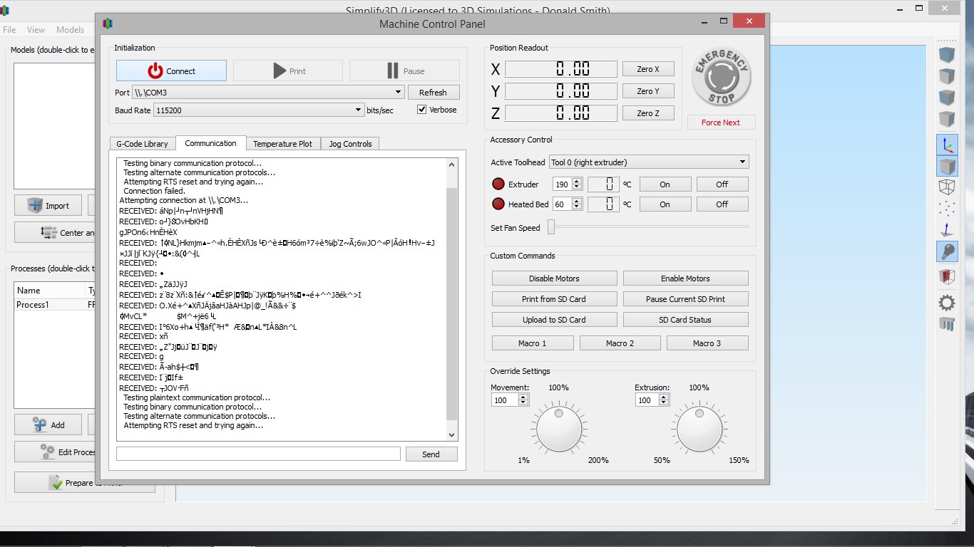

Insta,
I installed the firmware and my screen looks like this picture in simplify3D... Any ideas?
-Don
-Don
