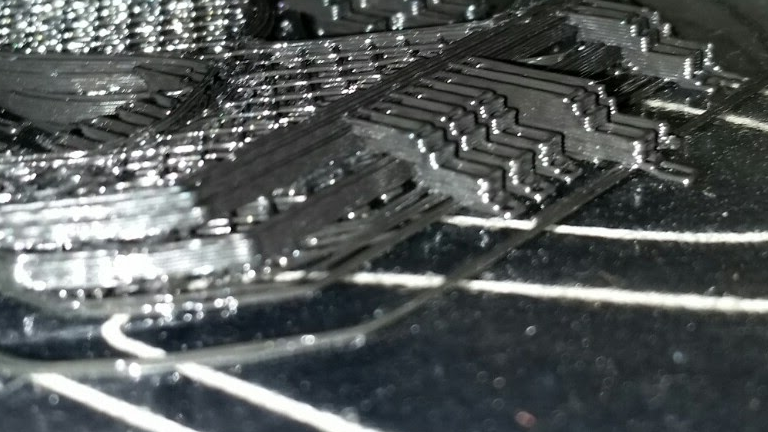

by Levi8than » Wed Nov 25, 2015 7:54 pm
I think this has been discussed on the forum, but not for this particular Marlin fork.
My X axis is shifing mid-print. This design was expected to print straight vertical.
I need to debug this.
