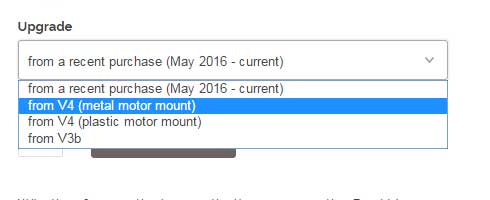

I've already added that to my list :D. I specifically chose this one from the shop because I purchased mine in March of '16:
