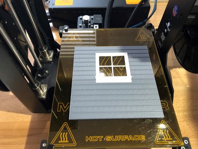

Just finished up my first dual color print, 1 out of 8 panels for a custom mailbox to match our house... Could not find a single source for how to use the dual extruders, so after playing around for awhile, this is the method I came up with:
- I sketched the part in Fusion 360. When extruding, I created one body for the siding and a second body for the window. Saved each body as a separate .stl file for import into Simplify3D.
- Imported both files, used the alignment tool to bring them together. Simplify3D auto positioned them too far back on the "Y" offset to allow for the prime pillar, only way I could reposition them and keep the alignment was to group them.
- Downloaded current Simplify3D profiles from the Makergear zen page - installed "M3-ID Rev 1 PLA 1.5" and created 2 new processes; "Dual Left" and "Dual Right" and assigned "Dual Mode - Left Extruder" and "Dual Mode - Right Extruder" respectively. Also had to select a model for each process. In my case, the window.stl (white) was in T0 and the wall/siding.stl (gray) was in T1.
As a side note, to get the siding smoothed out, I had to use the Variable Settings Wizard to print the base of the wall at .200mm and the siding at .075mm
Will try to post a picture...

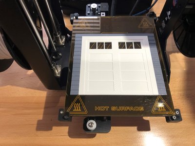

Also printed off the front 'garage door' which will be hinged to receive mail.
