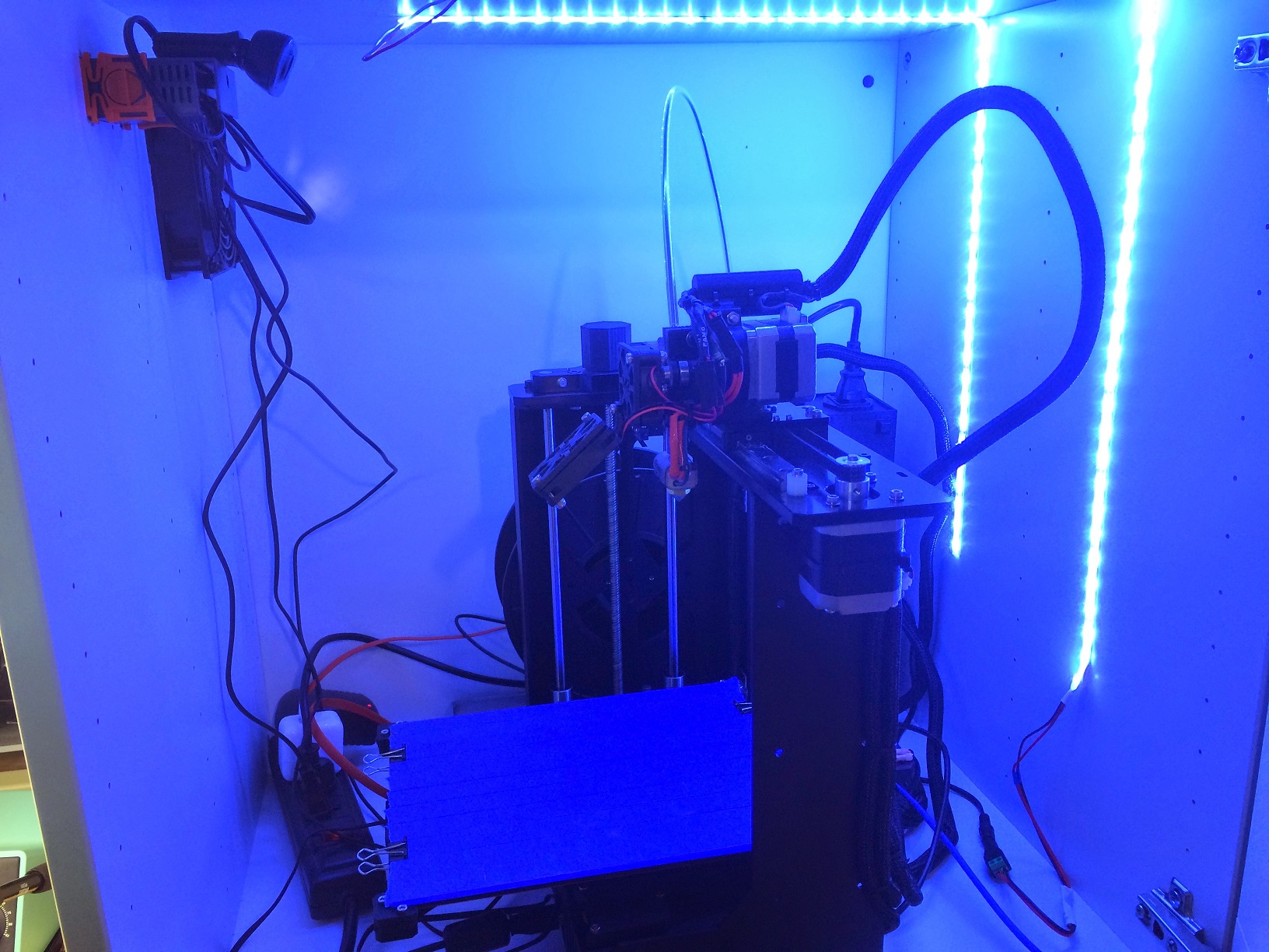

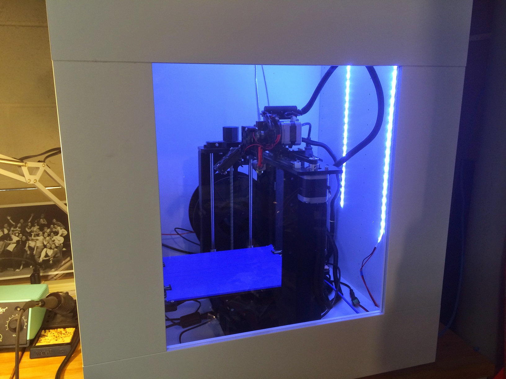

Here's mine, 90% of the way done. Everything is installed and working, though. Need to print out the holder for my webcam, mount the Pi (for octopi) to the wall as well, and do some wire management. Also, the LEDs while blue-tinted are nowhere near that blue in person. They're also remote controlled, which is both neat and fairly unnecessary at the same time!

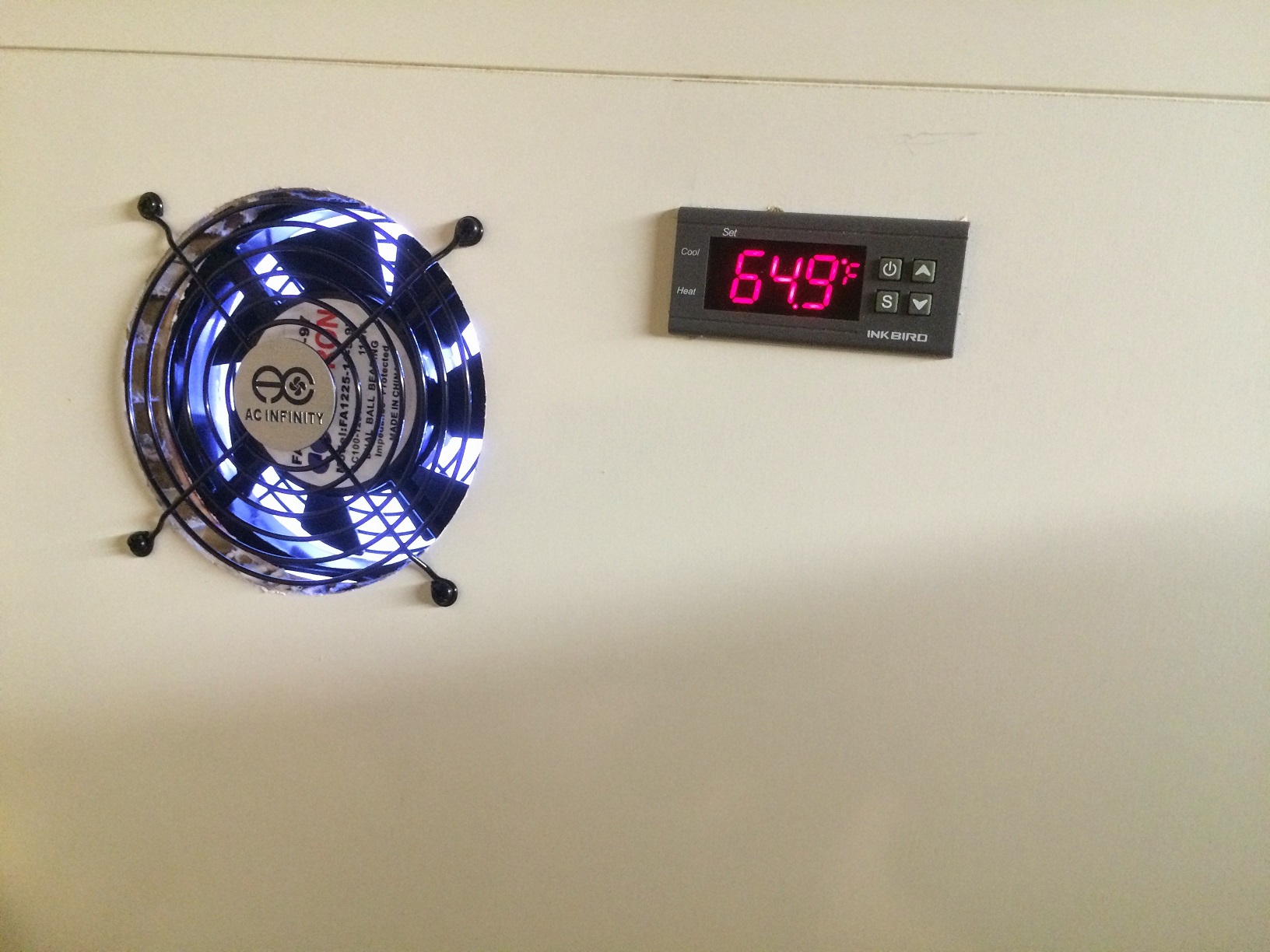

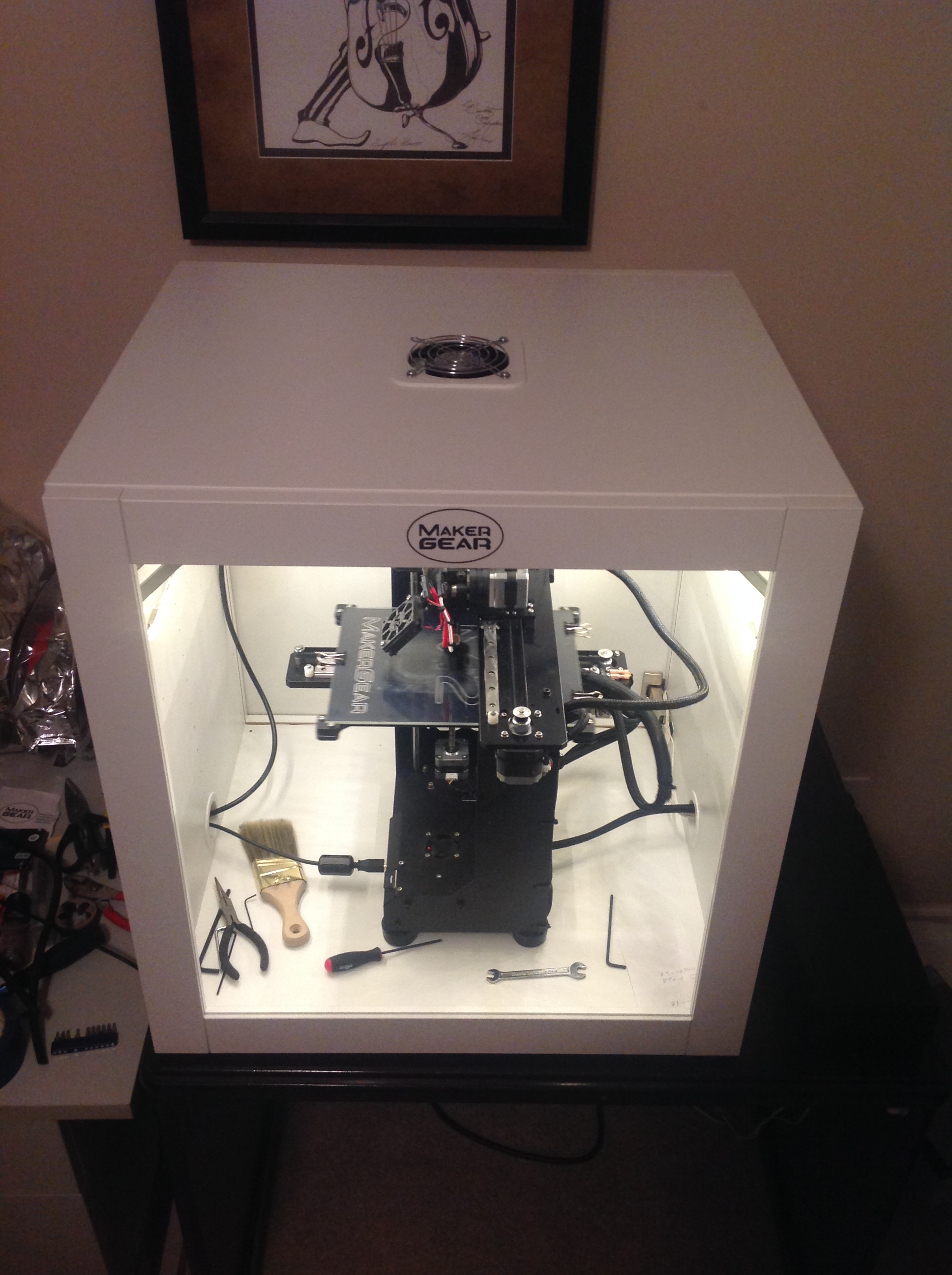

Hey Makers, first time posting here and I just starting getting into 3d design and printing this year. Thanks for all the tips and source links to build this. I just got mine up and running. It has been great for GREATLY reducing the noise and giving it a proper place to live inside my loft.
A few upgrades I am going to eventually add is a carbon filter for the exhaust fan, some additional sound proofing and a webcam to monitor the prints.
For the fan I went with this one
AC Infinity AIRPLATE T3
http://www.amazon.com/gp/product/B00QFW ... UTF8&psc=1
It is super quiet and the control panel is very intuitive to set. It works great to regulate the temperature.
Sound panels:
http://www.amazon.com/gp/product/B0002Z ... UTF8&psc=1
It would only recommend using this foam for the back and top panel. There isn't enough room for the machine to work if you put it on both sides. I am going to find a thinner lower profile foam for those areas.
I made a 2" inch cable plug incase anybody wants the source files:
http://www.14113.net/3dprints/cableplug/sourcefiles.zip
Here is my setup:
Thanks!
Adam

To those who have posted their temp-controlled fan setups, how are you finding them working. I upgraded from a 90 -> 120mm fan, but with the controller set at 31C (87F) after about 2 hours into a print (with a 70C bed heater) the fan just can't keep up, the fan is locked on, and temp started slowly rising toward 33C+
I do have the 120mm fan still running through a 90mm hole (with a duct/coupling I printed), so I could try cutting a bigger hole - and hoping the increased flow might help, but given how much its struggling now, I'm not convinced it'll do much other than prolong the inability to keep up. Next step would be to drill bigger out-take fan holes and mount a fan, and have both forced air in, and out.
Re: Modified Ikea enclosure
Post by jimc » Mon Mar 23, 2015 5:19 am
do you have good return airflow? that will choke it off as much as a small exit hole.
benavery
Posts: 110
Joined: Wed Jun 18, 2014 6:31 pm
Post by benavery » Mon Mar 23, 2015 6:20 am
Yeah you might be right. I have a row of 12mm holes along the top for exit (the fan intake is down the bottom, blowing directly over the RAMBO/PSU). But calculating the sizes, there is only about 1/6th as much exit as there is intake. I think I probably always knew that would be an issue, but wanted to avoid having to pull everything apart to get at it with the right tools to drill some bigger holes.

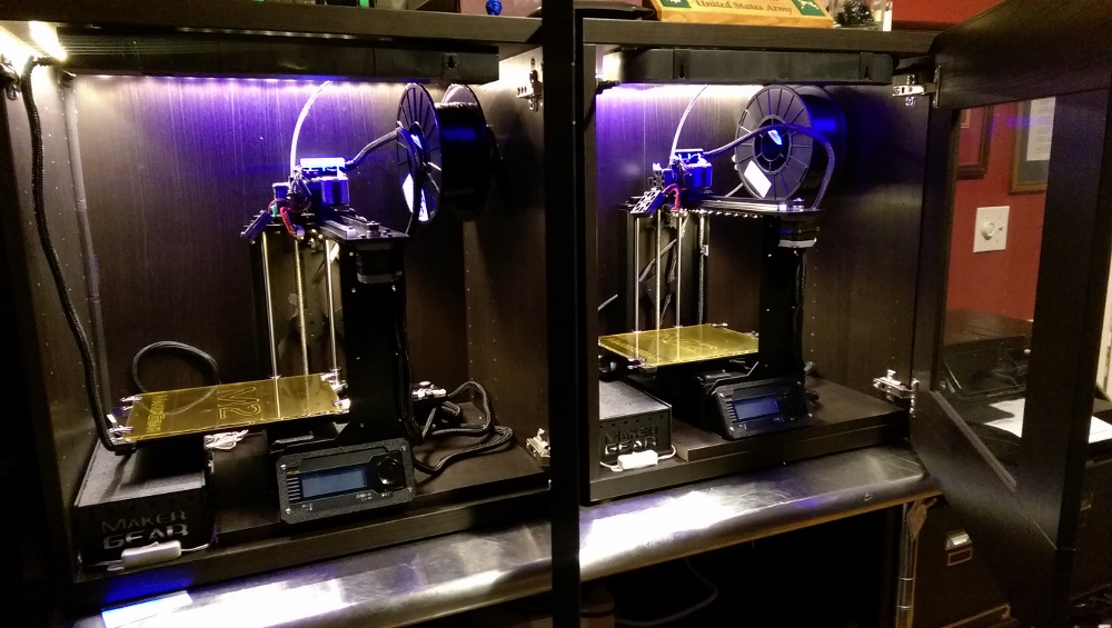

This thread inspired me and I enjoy the cabinets... Quiet printing, temp control, looks fantastic...
They are unmodified Ikea Besta cabinets... 23.5" wide, 25"tall, and 15.5" deep. The printers fit quite nicely once everything is arranged just right.
Regards,
-Don
M2's in Besta cabinets, LED's, Black Light
IMAG0334 (1000x565).jpg (335.3 KiB) Viewed 40078 times
