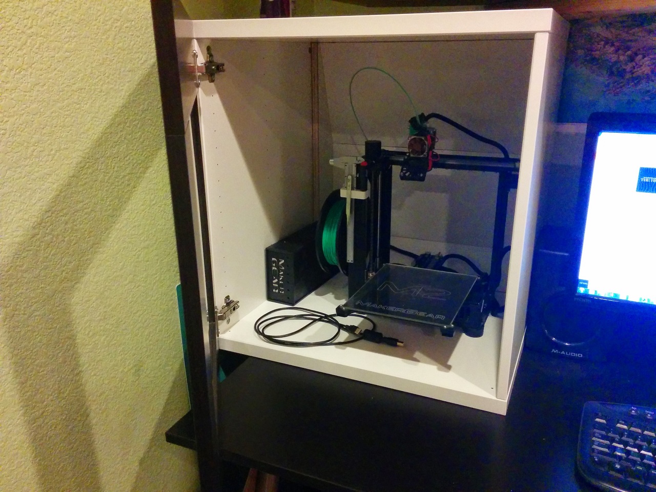

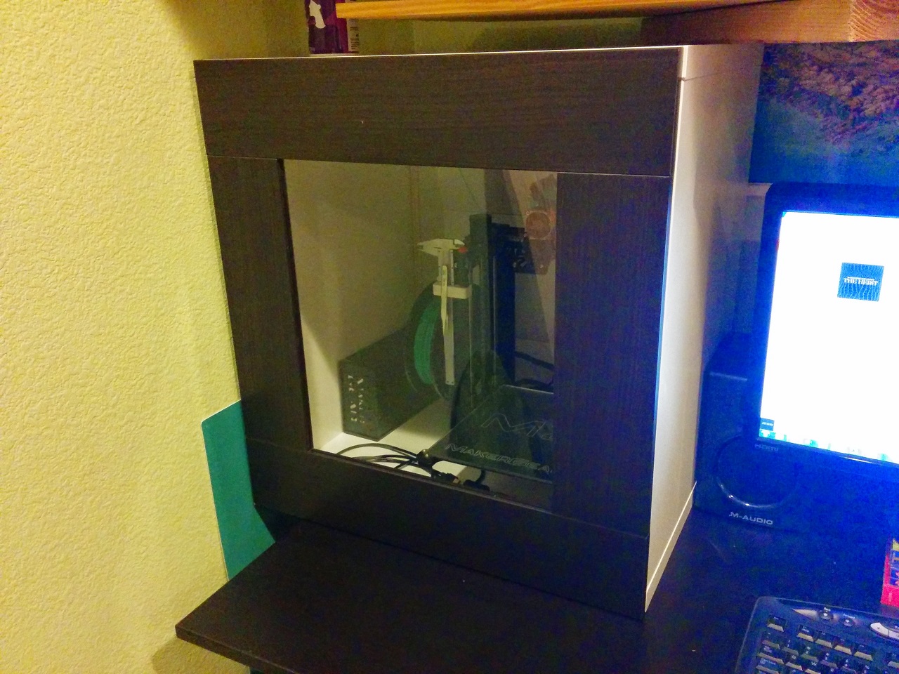

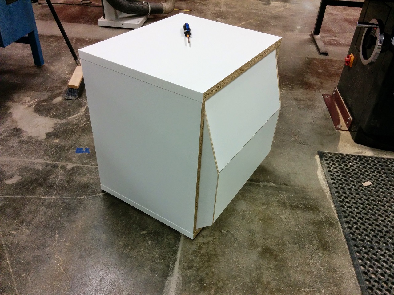

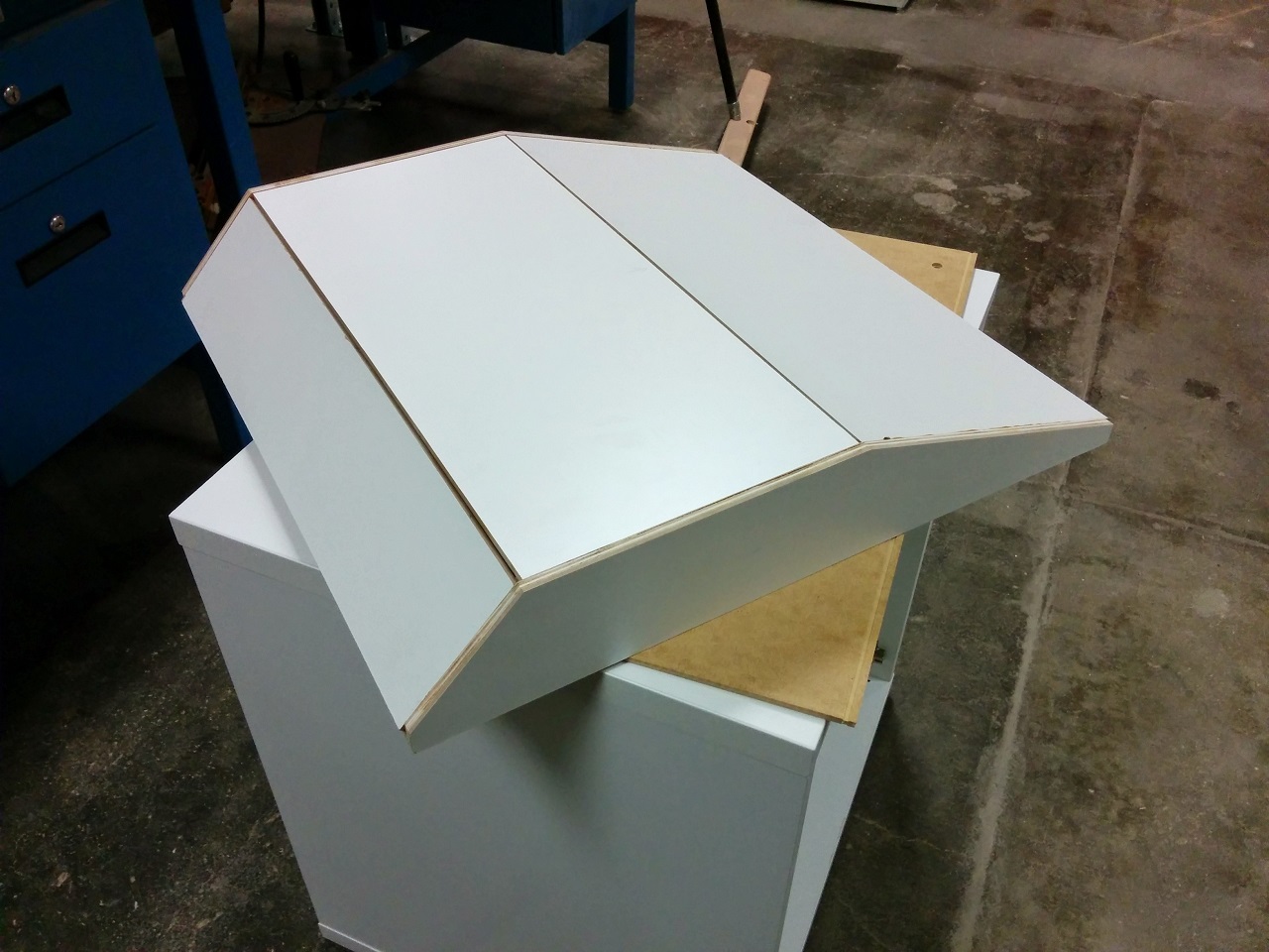

I bought the popular Ikea-parts M2 enclosure, but even a single print with the printer sideways drove me crazy, so I headed to a workshop and made some modifications. You only need to add about 5cm of depth to the box to get clearance. I made the back sloped, mostly just to look cool, as I only need the additional clearance in the box from about 9-32cm up from the base. I also made a last minute choice to make the new piece slide inside the existing box and fit into the existing slots at the top/bottom. Makes dismantling it everything super easy, as there are no additional fasteners. I still need some edge banding to clean up the visible plywood edge.
To be honest though, getting the new piece to fit exactly, and dealing with angles, probably meant the addition was about as much work as making a new box from scratch. Though I don't care as I chose to do so mostly as a challenge. The Ikea one has its benefits though - namely the nice looking glass door, and that the cheap panels they use are super light, which makes moving it easy. I think my tiny addition weighs more than the rest of the box, due to being make of solid 3/4 and 1/2 ply, rather than particle board and honeycomb.
For anyone wanting to use the nice cabinet with the printer oriented forward, but doesn't doesn't fancy woodworking - I'm fairly sure you could get away with making a new back out of foamcore boards, and some hot glue.
