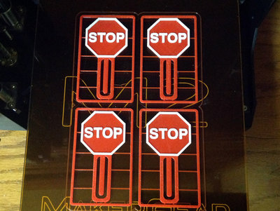

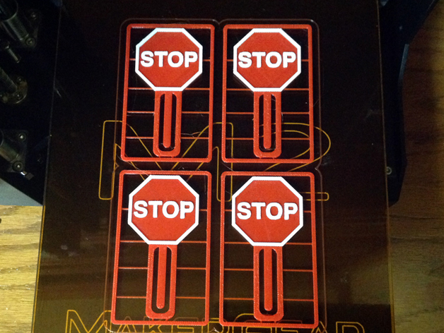

You can make your single extruder M2 act (kind of) like a dual extruder, and change colors wherever you want in a print, at a specific layer. The software does let you break up a print based on physical height measurements if you create separate processes, but you can also easily make the machine pause and give you time to swap out the filaments.

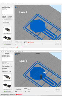

2. Make sure Preview By Layer is selected. Start clicking through the layers using the little arrows or the slider until you determine the correct layer for the color change.
Make note of Layer 5, that's the last solid top layer for the body, (you'll start to see the text). You will want to insert the pause code for the color change 1 layer higher. (Layer 6).

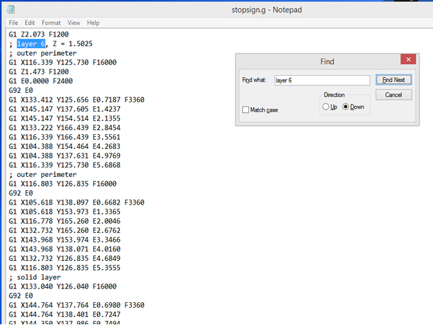

4. Find the file on the disk, and double click to open it in a text editor. (I use Notepad.)
5. Click on CNTRL +F to open the Find dialog in Notepad.
6. In the dialog box, type in "Layer X". (X being your layer number.)
Cancel the Find dialog.
Copy the code below, insert a blank line immediately after the Layer line that you found, and paste the code into the file.

If you want to try it with the file shown above, I'll attach it below:
