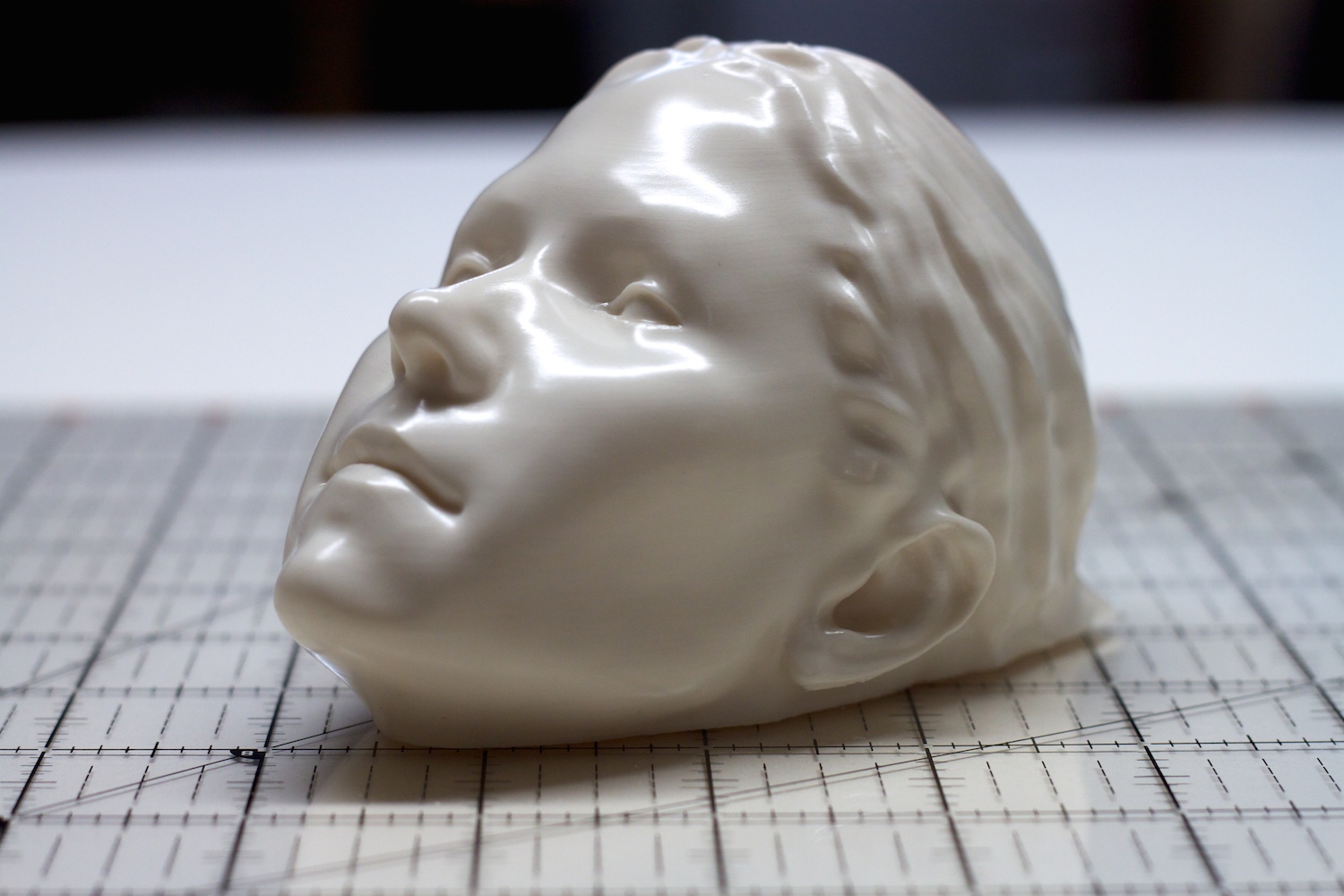

I spray on Rustoleum Triple Thick Glaze, (see attached example) usually four coats. The trick is to apply it as thickly as possible without allowing it to run.
- PLA .1mm resolution. Approximately 4.25 inch long. 2 coats Rustoleum Triple Thick Glaze Glossy + 2 coats Matte

That's a gorgeous finish, Jim!
Re: How to get a smooth finish on a PLA printed part
yes very nice!

@ jimschanz
do you have an image what your print looked like before you did that glaze? that looks killer. any tips on spraying on this rustoleum?
