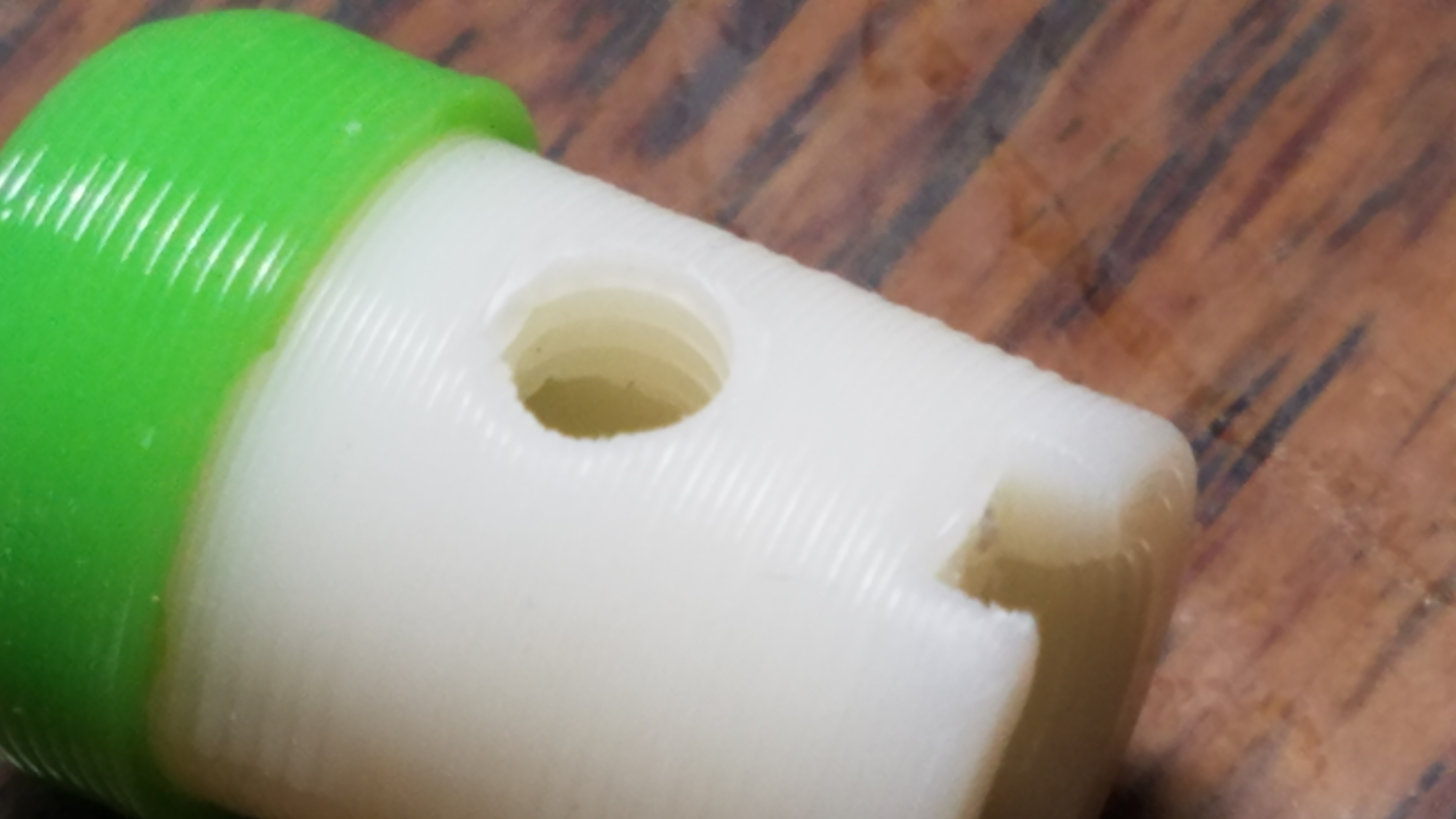

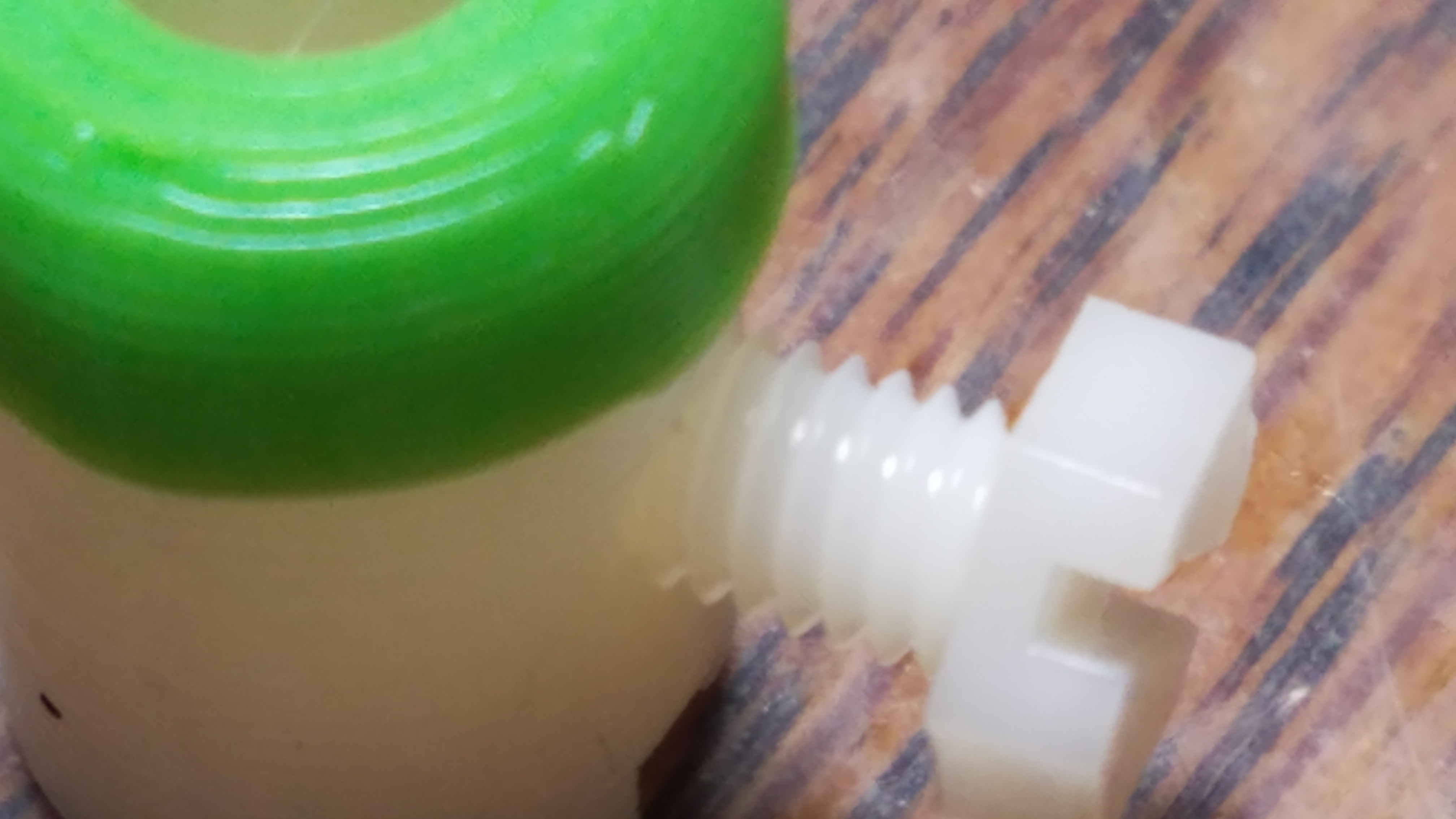

Have you tried just taping the plastic?? I have tried tapping PLA+, PETG , Nylon and ABS. ABS by far cuts the nicest, using a tapered tap and cordless drill and some compressed air as the tap is run in and back out. Attached is a part I have made a few hundred of and it is very fast an easy.

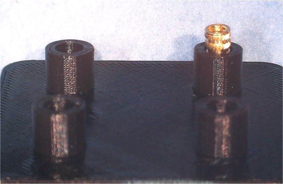

The last step in refining things was to get the holes for the inserts tuned up. I wanted the top to be beveled to leave room for a bit of ooze, but I also wanted to open up the inside diameter at the top so the inserts could be installed with finger pressure & sit vertically. The initial attempts had the inserts loose, and they would tip over a good bit, which made using the heated press very fussy to get them in straight.

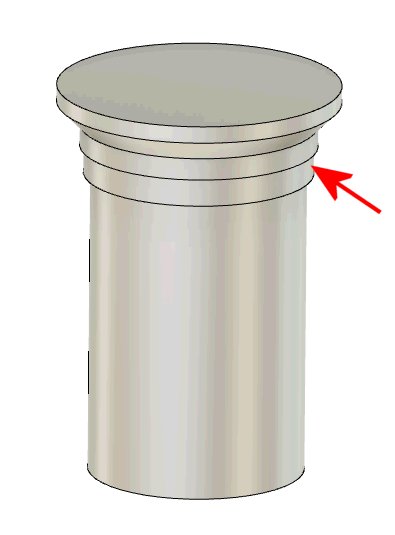

I came up with a stepped design for the hole that looks like this (shown as a 3D plug that I subtract from the inside of the bosses):

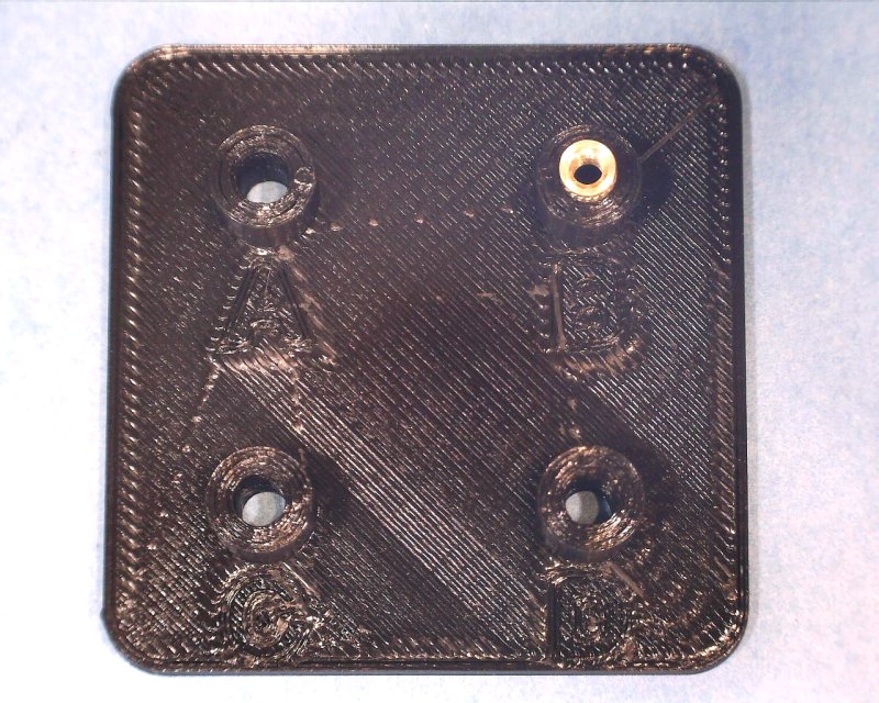

The arrow points to the critical diameter to allow the bottom barb of the insert to press into the hole. I designed a test plate, with four bosses with slightly increasing inner diameters, and printed that:
It turns out that option "B" was just right, and allows the inserts to be securely pre-loaded pretty close to vertical for easy installation on the press:
The first circuit housing went very smoothly, with 6 inserts installed. I'm running the tip at about the upper end of the nominal print temperature range. The inserts go in smoothly, but with just a bit of force. There's a tiny bit of "bounce back", where the inset wants to push back out of the hole a little, but if you let the iron/tip sit for a few seconds, that seems to relax & they stay put. They appear to self center nicely, and all the threads lined up very closely with the mating circuit board & hardware holes.
