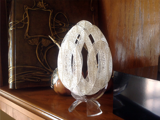

Just in case anyone (besides me) has trouble coming up with ideas, I knocked out a quick-print Lace Egg and just uploaded it to Thingie.......
Print it with the following settings to get the lace effect:
Top Layers: 0
Bottom Layers: 0
Perimeter: 1
Infill: 20%
Layer Height: 0.2 mm
Extrusion Width: 0.4 mm
And I threw in an assembly diagram. (You guys probably don't need it, but I put it in for beginners.) :)
http://www.thingiverse.com/thing:788001
(The one I uploaded has a slightly flat bottom, and does not need a stand....I just happened to have one around.)

That's really cool! A great gift for Mom.

Came out really nice
