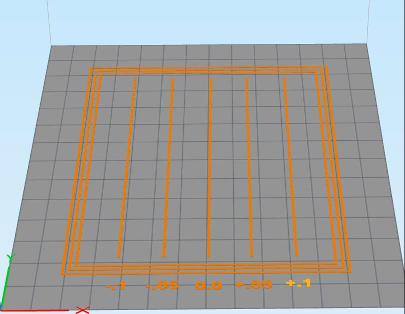

here is something i put together awhile back. wanted to post it here so more m2 users could find it. run this print to help fine tune your bed level. this will print very slowly so you can fine tune the lvl adjustment screws on the fly. the lines are printed at different heights .05mm apart so you can see which way and how much to adjust your Z stop bolt. note: 1/2 a flat on the Z bolt will adjust aprox .05mm.
http://www.thingiverse.com/thing:180970

mark, i think the height adjustment knob you are talking about would be the one on top that just turns the stepper motor. that one really shouldnt need to be touched much. just on occasion to tweak if you see the first layer goin down too tight or loose. the z-stop bolt is the one that should be adjusted to set your bed height. if you have that correct then you shouldnt need to mess with the other knob. 1 flat on the head of the bolt. that is an m4 bolt which has a pitch of .7mm. there are 6 side on the head which turning 1 flat would move the bed .11mm and 1/2 a flat .055. basically 1/6 rotation for 1 flat or 1/12th rotation for the 1/2 flat.
