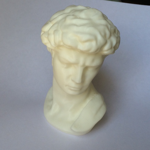

Printed this one for fun, at high speed but low layer height:

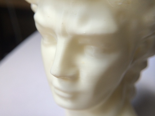

I tried to get a closeup shot to show the fineness of the surface, but it was so smooth it was difficult to get an autofocus lock:
david closeup.JPG (40.63 KiB) Viewed 20507 times

Nice. Is that PLA? Did you get the finish by raising the temp?

ABS. No warping or delamination, which I attribute to three factors:
1. Model is vaguely cylindrical, with no really long runs of straight filament,
2. Support surrounds almost the entire head due to the bouffant hairstyle, insulating somewhat from drafts and trapping bed heat, and
3. I'm printing at .40mm extrusion/.10 mm layer height, which should give very good layer bonding in the perimeter.

man jin that looks good. i cant see any layers in it at all
