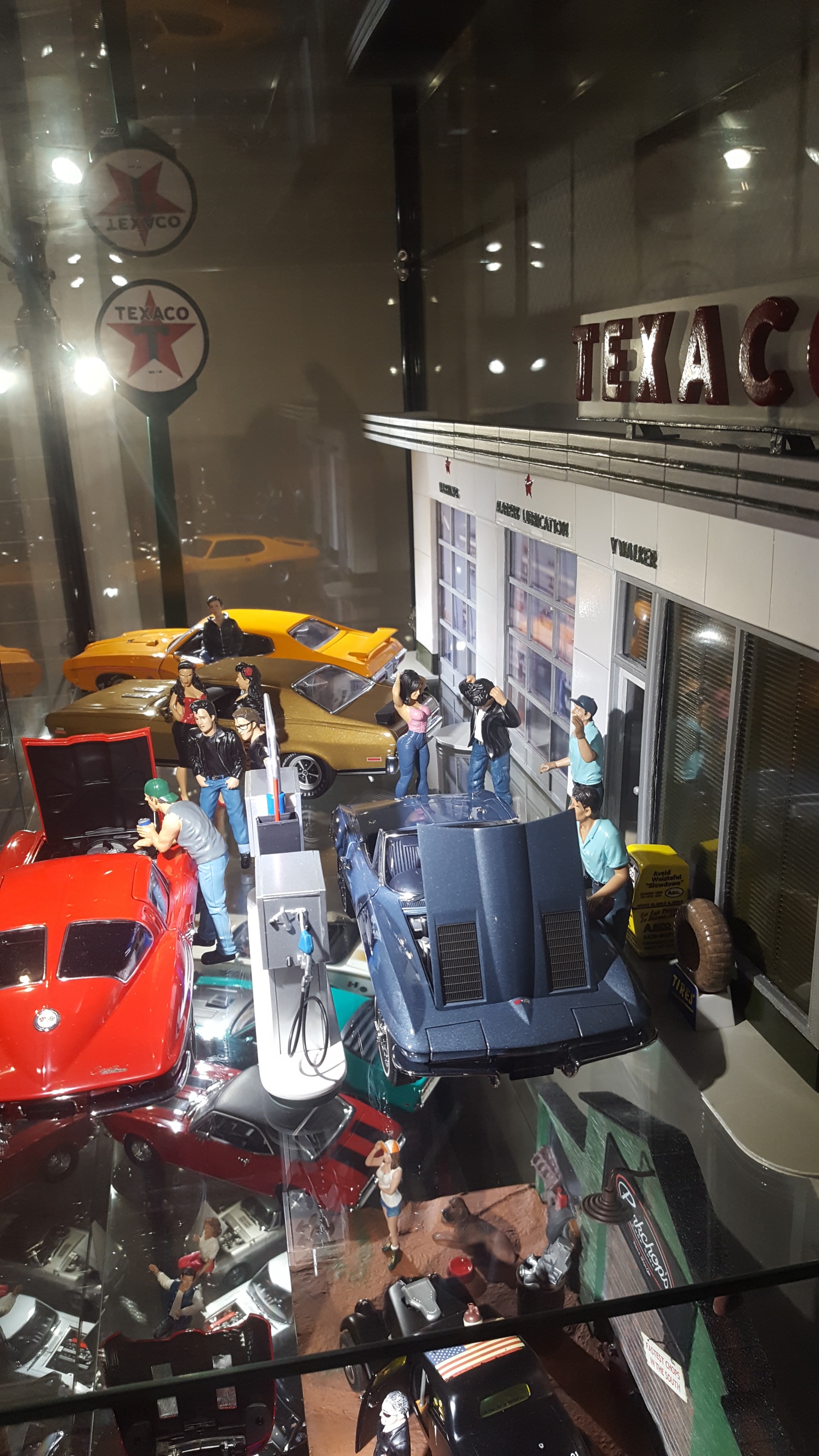

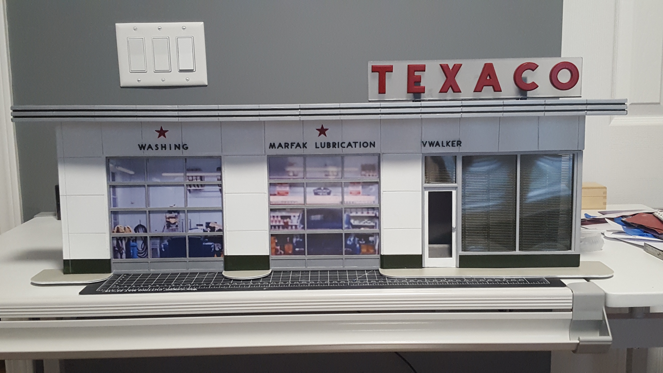

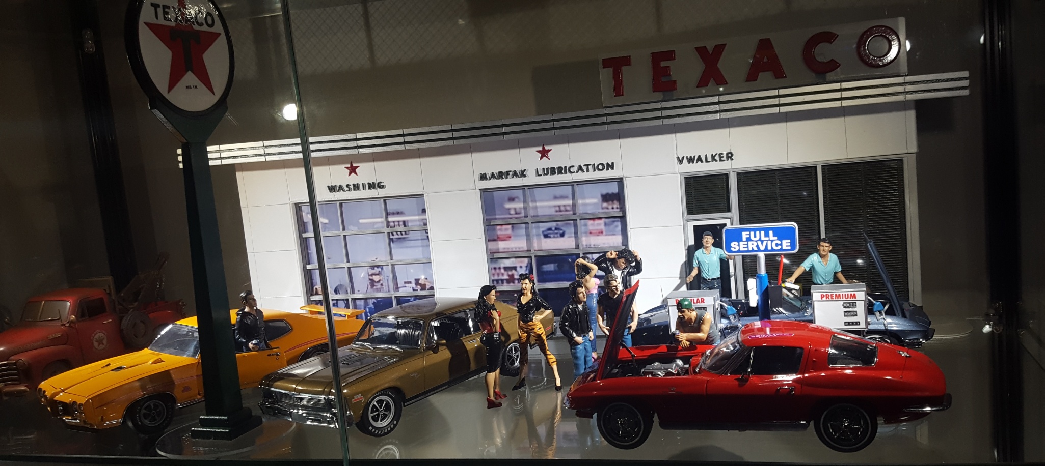

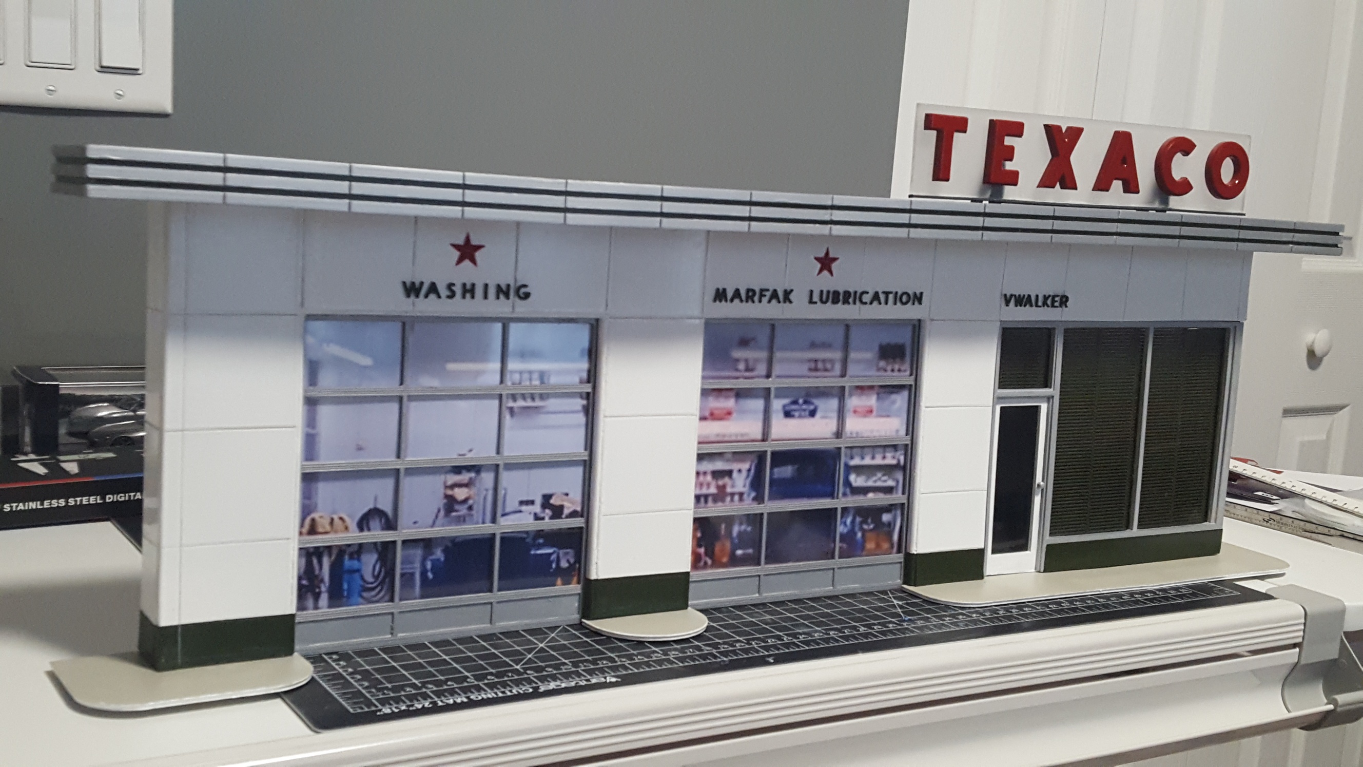

.I got interested in 3D printing to create diorama pieces for my 1/18 diecast car collection. This model is my first attempt of a vintage Texaco Gas Station for my American 60's-70's era shelf. I duplicated an existing restored Texaco Station located in Arkansas by looking at 5 photograghs of it, I've never actually seen it in person. I've included one of the photographs of it for reference. I've worked the last 30 years as an Automotive Design Engineer with as many years experience using various CAD SYSTEMS. That said I made all my own models from scratch developing the scale first by printing one of the photographs and measuring the height of the door and from there developing a starting point for the scale factor. Then I put the ABS 3D printed door next to my diecast models and figures for a couple days to see if it seemed correct. The final model is comprised of nearly 50 separate printed pieces. The only pieces that weren't 3D printed are the roof which is a sheet of ABS, the sign back is a sheet of clear acrylic, and the windows are ploystrene sheets. Finally I assembled it primarily with acetone fusing since ABS filiment was used exclusively. There were certain instances where I needed model glue and clear window cement, everything was painted with conventional enamel modeling paint. In the future I plan on expanding on the diorama by adding the phone booth and a better pump island. Then maybe I'll start developing some of the inventions that have been floating around in my head for the last several years. Thanks for looking.
Finally done!
Iso View on Work bench
Placed in the display case for the first time
Side View in display
