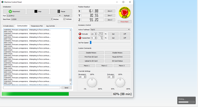

Having this issue intermittently on one of my M2 Rev. E. It will pause the print , and sit there spitting out this error. Any ideas?
Thanks!
Cameron
The place to look is just before the first occurrence of that error message, where you'll find another message suggesting what caused the firmware to stop responding.
This may require considerable scrolling and maybe enlarging the scroll buffer, but that's the only way to make progress.

Can do! Once it happens again I'll snag that info.
