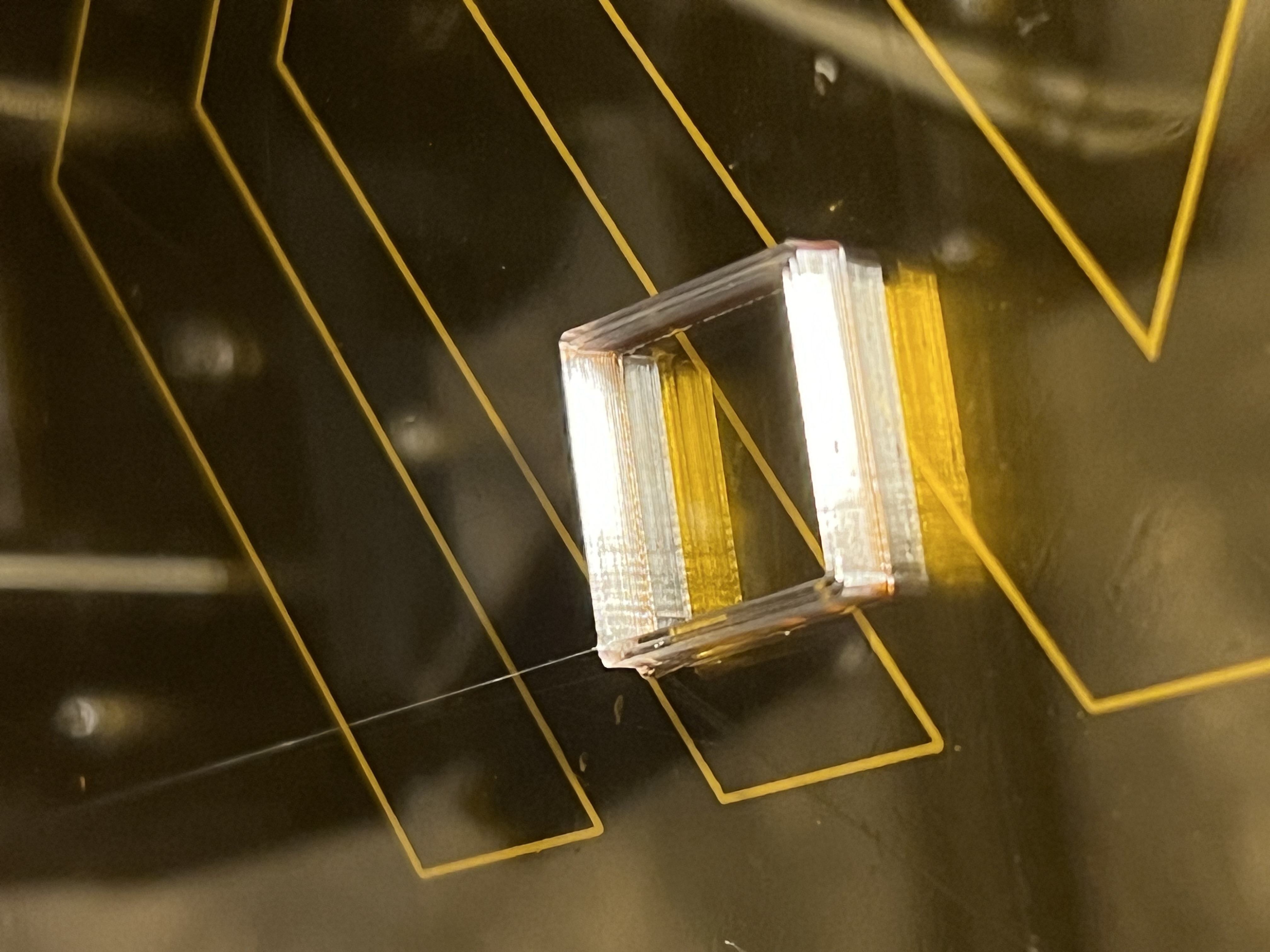

Can't quite figure out what's wrong here and how to fix it. I've tried releveling twice.
For a year everything was perfect but I accidentally deleted my S3D profile and now nothing works.

I am not sure what I am looking at, what type of filament is that, what nozzle size are you using and what layer height.. Once I know that I will give you a factory file to print and we will see what come out. Looks to me like the starting height is too close
It's PETG at 230 degrees with a .5 nozzle and a .2 layer height.

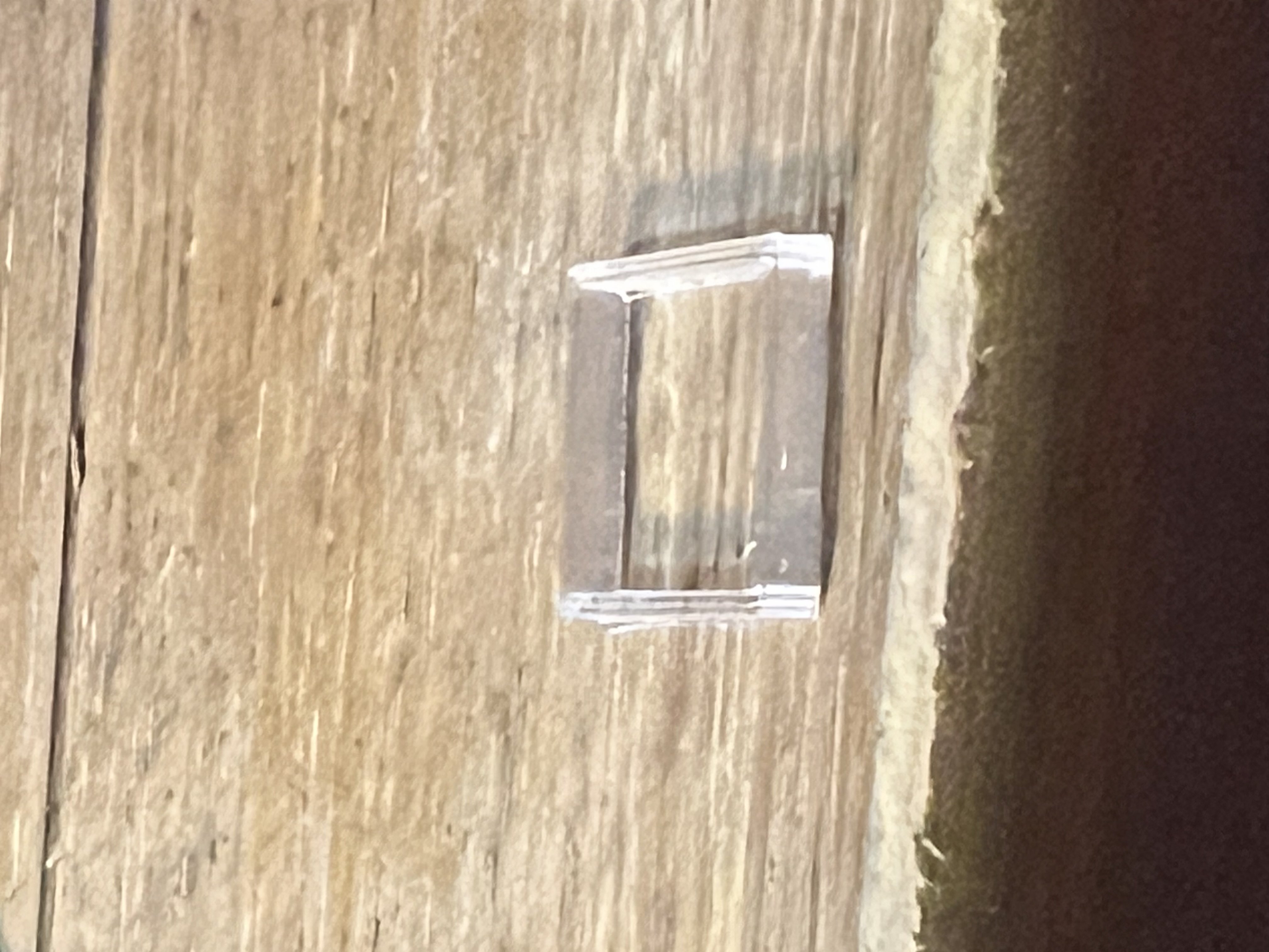

This prints ok, I'll find my tool and measure it for evenness. I suspect one core is higher than it needs to be and that's why the printing is worse as it gets to that corner.

it should be 3mm tall +- .02 and 1.1 - 1.13 mm thick.
PETG does not like thin layers if you are trying to print at .1 mm or something that is not going to work well
I use Overture transparent all thee time, great stuff.. but if Z offset is too close will not work out well at all .

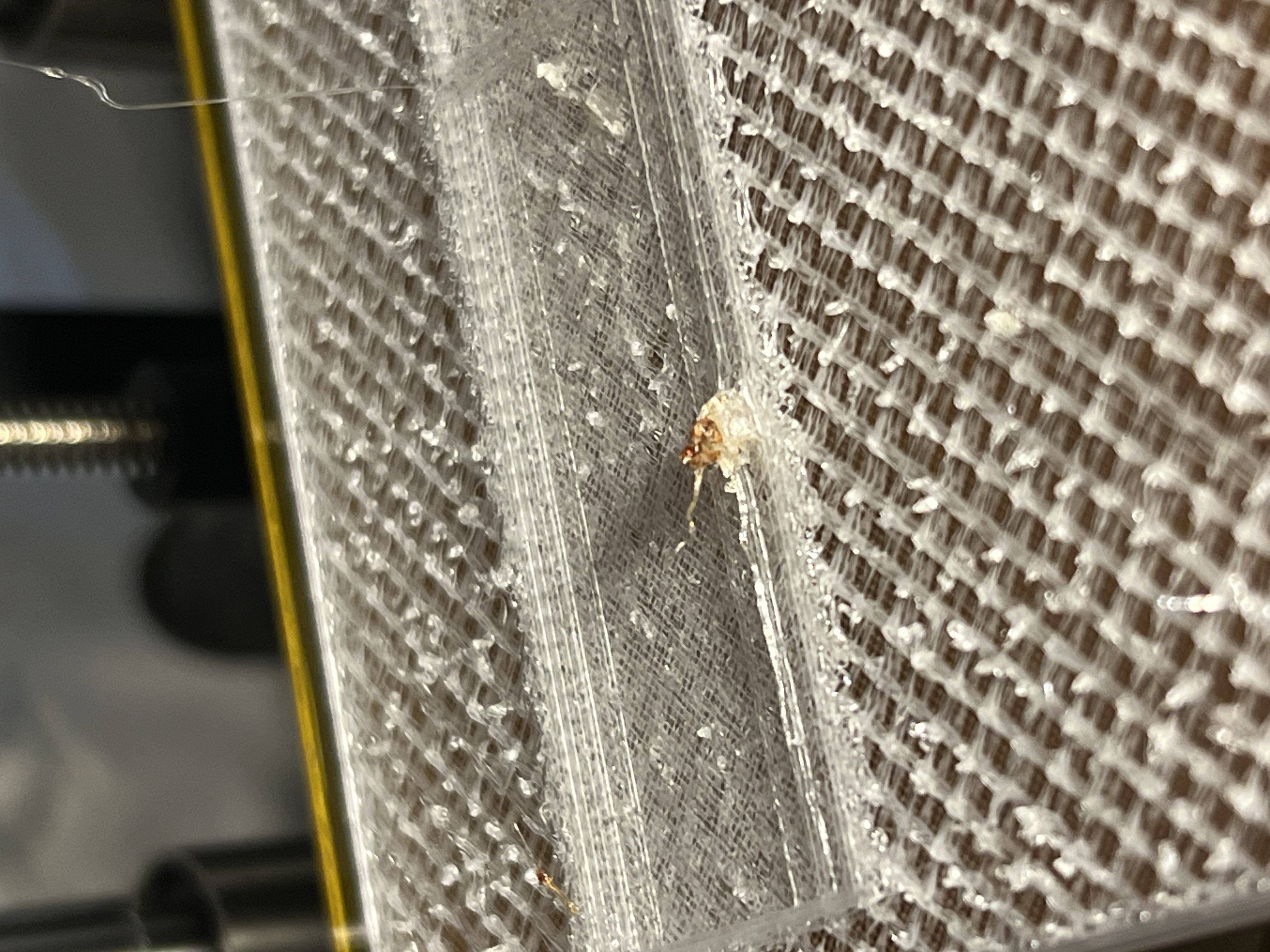

So I was wrong, getting this now. There is still some stringing in the fill areas and thats where this is getting picked up. I slowed her down about 10% and doing another test print to see what I get.
The first layer is now pretty perfect, we'll see what happens when we get up to fill.

I think you may haver your extrusion multiplier a bit to high and maybe starting Z is not correct, did the square come out at 3mm tall and 1.1 thick? The ugly gob poop is indicative or PETG and can be made worse if over extruding or too close on the start Z offset.. even with all things perfect it still happens.. nothing worse that white PET top layer with a brown turd on it..
