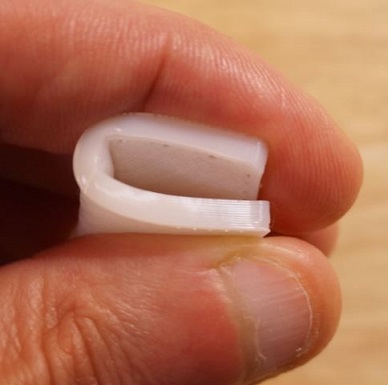

I finally got this stuff to print. Here's what I did make it work:
Pare the filament tip to a sharp point on several sides, so the tip is in the center.
Load the filament by taking the filament drive off the gear and hand threading it through the drive and into the hot end.
Mount the filament reel a few feet above the M2 directly over the filament drive.
Switch to a .5 mm nozzle and set the extrusion multiplier in S3D to .9
Send the command M203 E1 before doing any extruding. It slows the feed rate down to 1mm/sec. Also put the same command in the S3D start script.
Print at .25 mm layer height with retraction turned off and print speed set to 900 mm/min. No outline underspeed or first layer underspeed. The idea is to keep the filament flowing at as constant a rate and pressure as possible.
The manufacturer also recommends modifying the filament drive so that the hole from the gear to the hot end is large enough to accommodate a piece of PTFE tube with an inner diameter of 1.9mm
It printed slow as molasses but just getting it to work was good enough for me. And the stuff is bendy:
