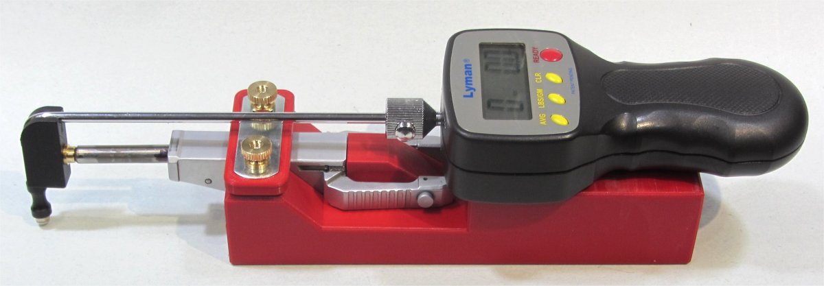

If I can buy it, I usually will, although sometimes poor quality pushes me into making my own. I've got a huge list of things that are one-of-a-kind, or are no longer made to keep me busy.
As an example, I just finished making a fixture to measure the recoil spring force in the bolts for Benelli .22 target pistols. The college team has over 20 of them, and Benelli has stopped exporting parts to the US. The springs have gone through numerous design changes over the years, and some springs don't work well with the ammunition we can get.
It uses a trigger pull gauge to measure the force. I now have a growing set of data on what springs & forces work with what ammunition. That should allow me to order custom springs that will keep us going for another decade or two.

Gwhite, that's very nice. Is the aluminum grip ?? just beneath and in front of the gage part of the original gage "assembly" or from some other device?

The complicated silver piece clamped into the fixture is the pistol bolt. The tube sticking out on the left end of the bolt is a guide tube that houses the recoil spring. The force gauge has a 3D printed adapter with a brass insert that pokes into a hole in the end of the tube. You slide the gauge to the right, stopping when the tube is compressed 3 mm, or when it is fully telescoped into the bolt. Those positions correspond when the the bolt is closed, or fully open in recoil. If the closed bolt force is too low, you get incomplete combustion, lots of carbon build up, and the recoil won't cycle the pistol properly. If the force is too high, the bolt won't come back far enough to cycle things properly. There's a happy middle ground, but it can depend on the ammunition. We have some pistols that will only work well with expensive German ammo that costs over 3 times what we can get good Mexican ammo for. They just stopped importing the German stuff. We have enough left for this season, but by next Fall, I need to have the springs sorted out so we don't need it any more.

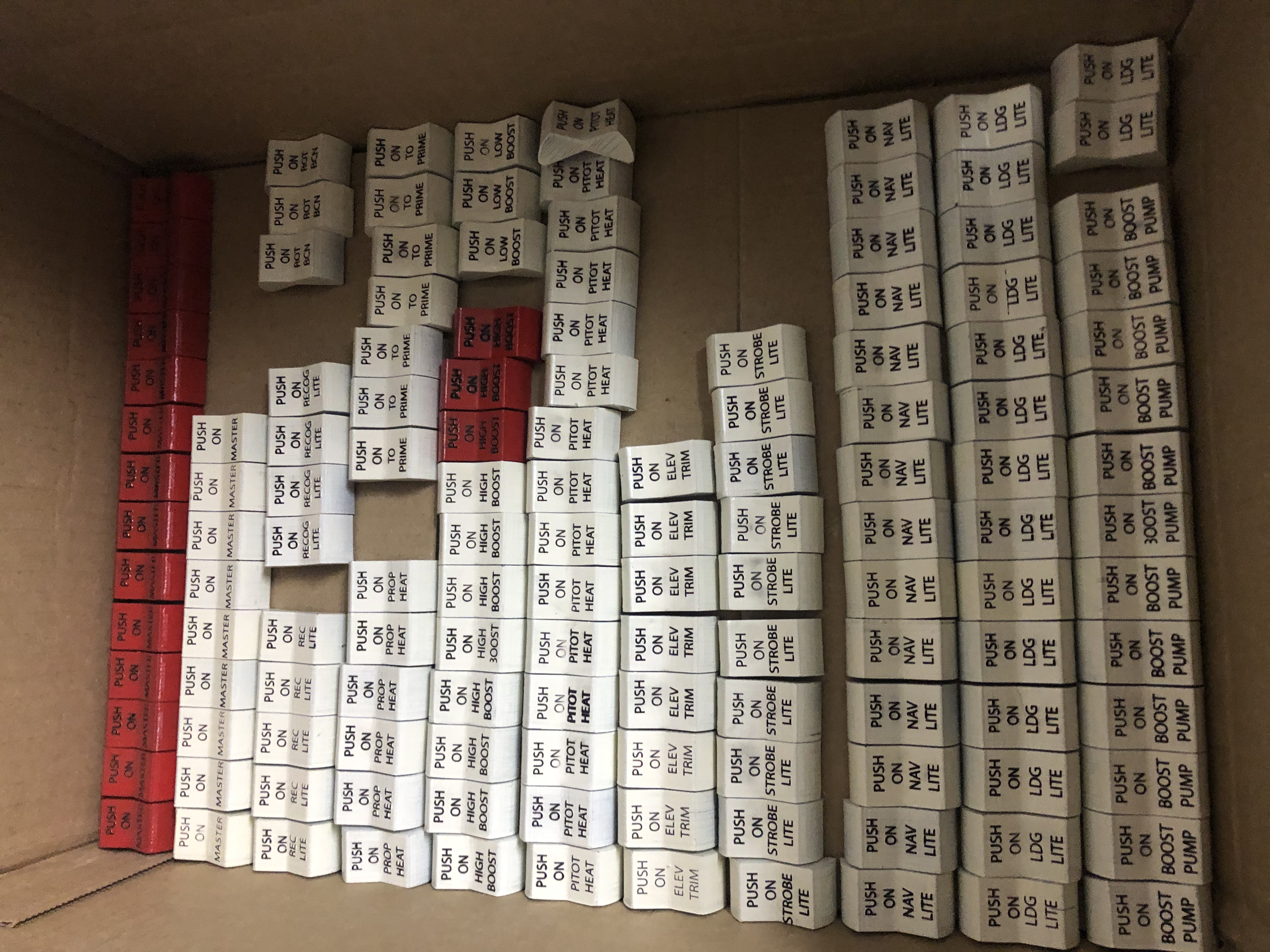

I also make things for aircraft. I have sold hundreds of these:
They also take painting and laser etching. I am working on other items, as well.

Nice switch caps! How do you do the lettering, dual filaments?
I'm surprised the silencers don't melt, unless you have access to a sintered metal printer or some such.
I've printed lots of stuff with inset lettering, but coloring them is pretty tedious. If you don't seal the print with something like Floetrol, the ink wicks into all the little gaps & you end up with a mess. Even with a couple coats, it's hard to "stay between the lines" if the lettering is small. I've found some fine tip silver paint markers that work OK, and you can whittle the tips to be even finer.
