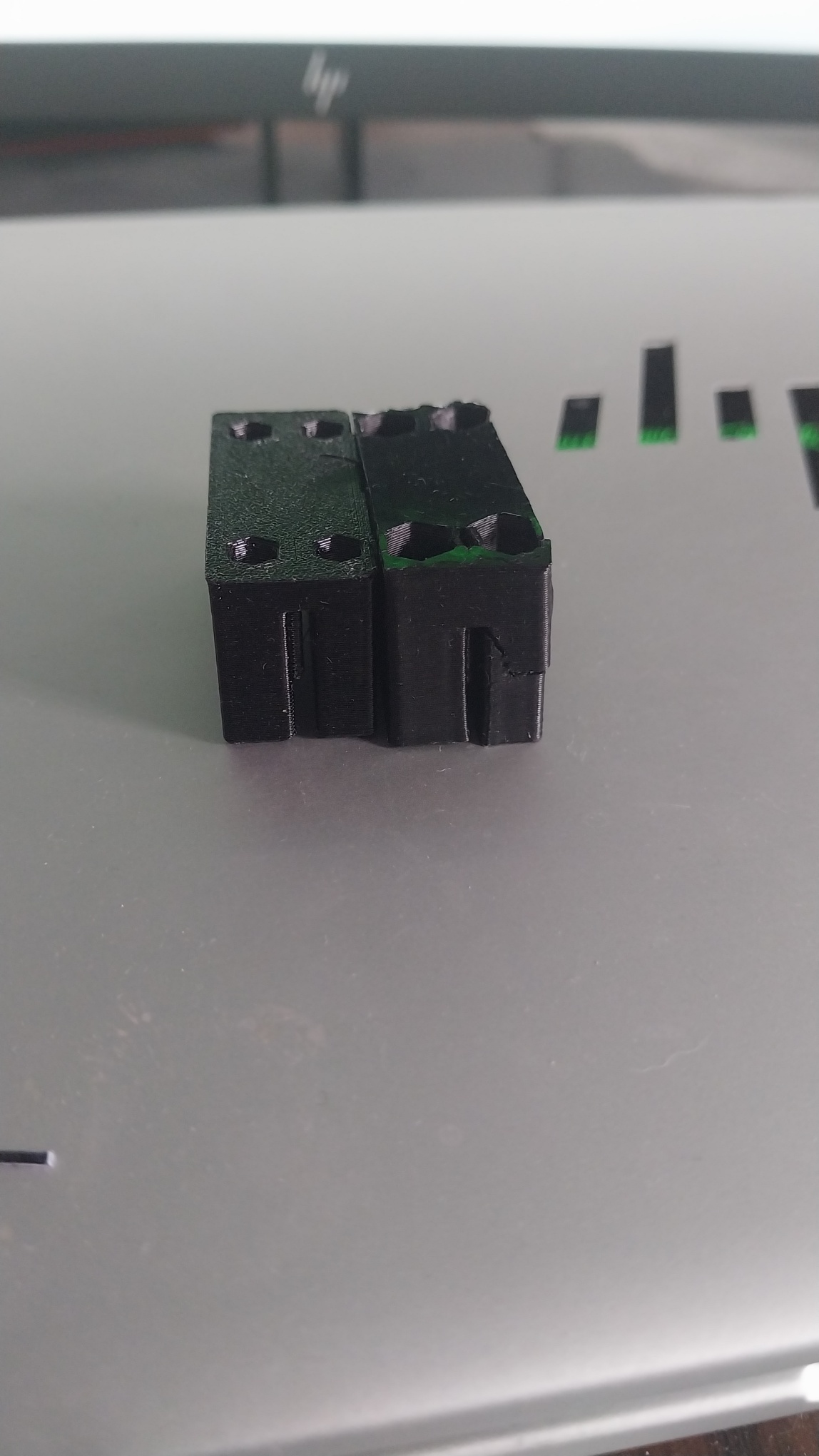

My printer was purchased in 2018 and must have an oddball belt camp. It uses M3 screws with nyloc nuts.. there are 3 different camps on github and none of them are this. The one under RevE prints with M2 holes and nut pockets using a .25mm nozzle.. Need me some Jed so I can Clampit!
Anyone have this one?
The one on the left is the new one RevE off github the other is the original from the factory.

I wonder if they switched to using whatever is in the M3? It might be worth looking on github for the M3 clamp files.

My guess is someone updated that with the wrong file. Guy emailed me from support with a link to that is on Github for RevE.. what I printed and is incorrect. They are sending me one that looks correct from the picture Karen sent me but there is nothing for scale so could still be wrong.
I pulled the step down and the holes are 2.4mm so I opened them up toe 3.4 and made the nut pockets 5.8 and it works, but walls are nonexistet on one side of the nut pocket..
