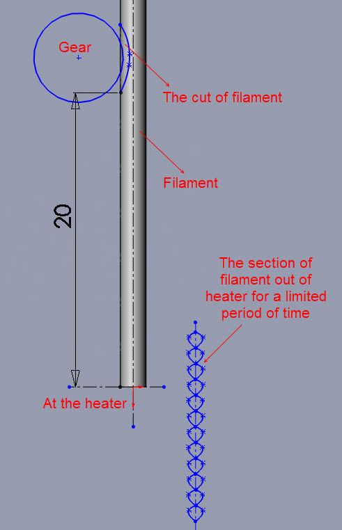

We remove the heater away the gear and let filament go through the slot by hand,that it can work fine.Then we assemble the heater on the gear,the filament can be out of heater for a limited period of time,with a rough draw showing the cut of filament and fuse filament section,see the picture.
the scrap.jpg (34.03 KiB) Viewed 14802 times

by jimc
ok so the filament isnt actually breaking, the gear is stripping out on the filament. this happens for a few reasons. one can be the temp is too low. a second is that the extruder is clogged or getting tight. the extruder can get tight or clogged from poor filament or switching plastic types often. in any case, unless its temp related then its probably time to do a hot end cleaning.
