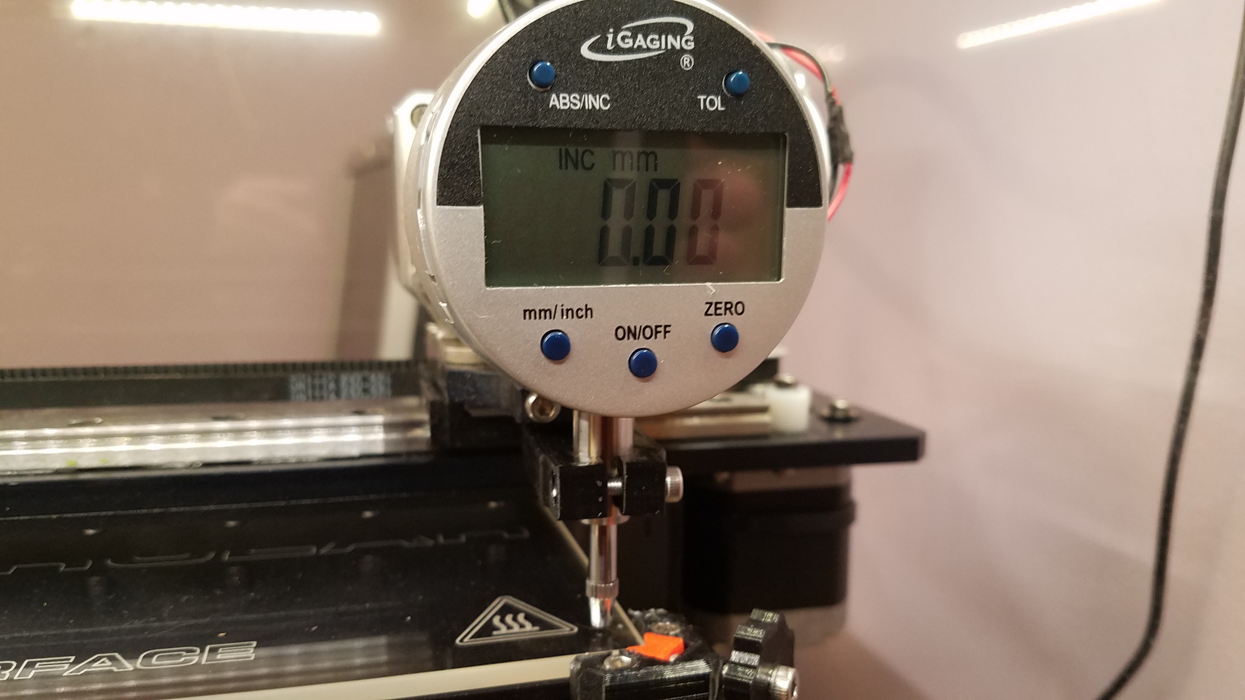

I have made an adapter that attaches in place of the hot end and will hold a dial indicator. Last time i use this I manually move it around the bed taking measurements. I would like to have 12 or 16 locations in the script with a pause between each that would then move on to the next on when something is triggered.. (Using Octoprint console)

Never mind.. I figured it out.. For the next newbie who want to level his bed or fix a bowed gantry
I have attached the DI mount SLT and the gcode to move it around the bed. The plunger spring in the DI must be removed to allow gravity only pressure on the plunger or it will actually mover the bed under the spring pressure.
Gcode should be really be called measuring.gcode as it does not level anything
This the DI I puchased https://www.amazon.com/gp/product/B00U6 ... UTF8&psc=1
Just remove the back and the spring so the pin drops on the bed with gravity only
