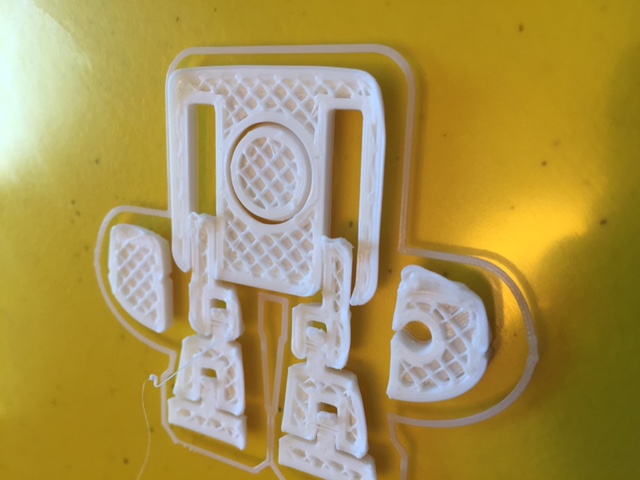

So I am still having problems. I have kept trying to dial in the settings according to the print trouble guide over at simply3d but they don't seem to be helping.

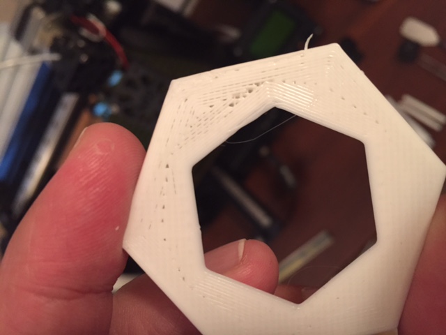

I kept at the thin wall box but never managed to fix rounded corner issue. I tried printing the hexa demo file but the bottom was still gapped on one side and the top again had thin filament that didn't fill in with the last couple layers pulling away at the corners.
I re ran the platform leveling and it said it was level. I re did the starting height adjustment.
So I tried the full box and adjusted my extrude multiplier till the last two layers were filling in and making a solid top just up to .94, but the corners were still bulging out and the size of the box was 20.2.
Then I decided just to try and print something else and just see how it worked out. in simply3d I set the temp to 220 bed to 70 extrude to .90 speed to 3000 mm/min and printed the makey robot. That went really bad. by the first cm it started pulling up off its self. guide said not enough cooling and printing to hot. so I put a box fan behind the printer, dropped the temp to 205 and tried again.
Those didn't turn out so well either. I dropped the temp again to 190 speed to 2400 and tried again. Same problems, bulging corners, warping on the over hangs.
I reprinted the demo pieces, bracelet comes out ok, Hexa comes out with gaps and top layers to thin.
I just don't know enough to know where to go from here.
You did the right thing checking the level and resetting the starting height on that hexa print. What you don't know yet is that most white filament is a pure-D-b*tch to print. It's the nature of the additives in that color or something, and it frequently thins out and sometimes stops completely. So don't be surprised or frustrated when it happens, just reprint.

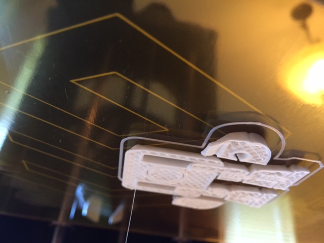

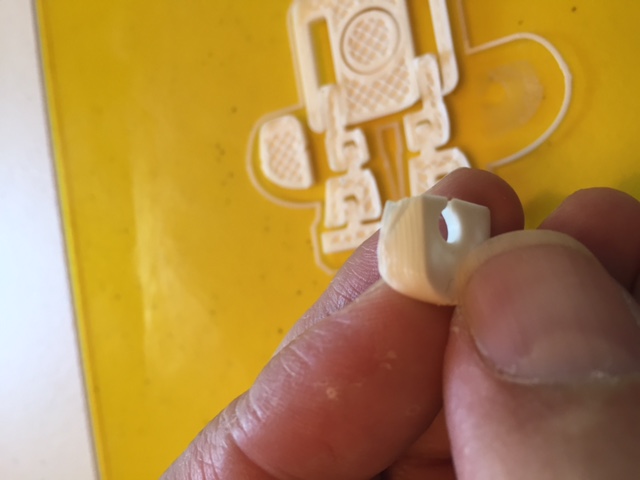

....printed the makey robot. That went really bad.
That is a small PLA print with overhangs and a small footprint. And it's warping because it's too hot.
1. You need to cool it off a lot.
Point a desk fan at it, (or take off the fan guard on the bed fan), print with support, and use adhesive on the plate.
2. Do not print the PLA at a temp over 205° to 210° when you have overhangs. (Lower temps are fine if you are getting good bonding between the layers.) Take the bed temp down to 55° to 60° and use adhesive. Hotter is not better with PLA.
The hotter you print PLA, the longer it takes to cool down, and the more warping will occur while it is cooling. (Once it cools down, it stops warping.)
3. Use support under the warp prone areas. (In general, not necessarily for that particular print. The overhang areas are small.)
