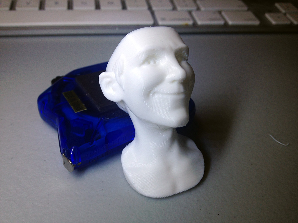

Here's a few prints from my M2. Not quite the quality I'm getting from my Printrbot Simple Metal yet but I have a lot more time with that printer. Any thoughts on tweaking to get my quality up a bit? This is PLA @ 215c, 70c bed temp, .2 layer, Simplify 3D.

A few things stand out...
The retraction zits generally come from not enough extruder acceleration (a firmware setting), which causes the extruder to spend too much time in one spot while inhaling the filament. Increasing the retraction speed won't solve the problem if it's already moving as fast as the acceleration will allow, but you can start there; if nothing changes, then goose the acceleration and then the speed to suit. If the acceleration gets too high, then the extruder will miss steps while retracting; back the acceleration off and you'll know the limits.
Although I don't use S3D, (IIRC) it offers a coasting time that allows the extruder to depressurize before retracting and changing layers (or whatever), so perhaps increasing that delay will have much the same effect as increasing the retraction acceleration.
There's some oscillation in the XY plane, which you can reduce by backing off the XY acceleration values (more firmware settings). Start by cutting them in half, then tweak from there. That may also be due to not having the platform support screws tightened down to compress the springs, as the only thing holding the platform in the XY plane are those screws and springs.

All in all, though, those models look pretty good for starters... [grin]

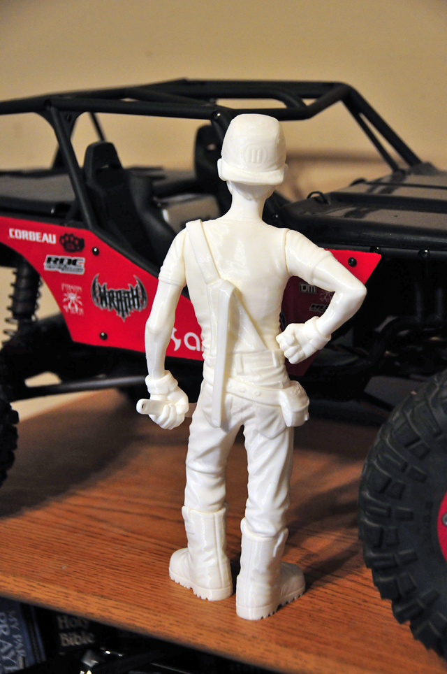

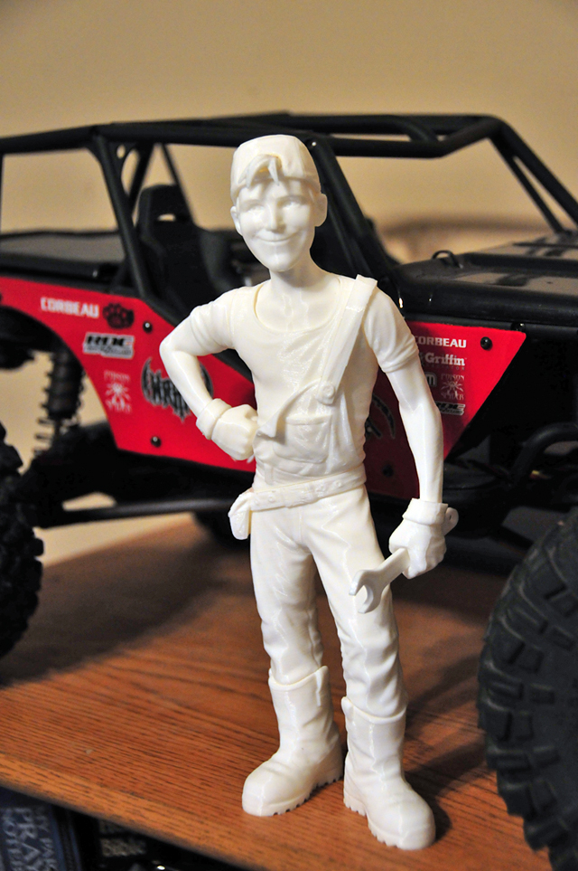

At this point in time I've pretty much just used rsilvers profile to get where I am today. The PLA profile seemed to work pretty well. I just make sure the bed is good and level, extruder height set and then tweaked further with the G-code Z off set in S3D. I also heat the bed to 65c and use one sheet of 4mm Kapton tape to cover the glass. Parts stick good and pop right off when the bed starts to cool after the print.
I know theres still more quality to be had out of the M2 but now it's just a limitation of my knowledge... which of course I'm working to improve. Right now I'm trying to find that good mix of speed but still keep the quality up. Here a couple pics from the completed model today.

the quality of those prints is amazing. would you mind sharing the print layer qualtity? i'm still trying .2mm at the moment. i'm trying Rsilvers at the moment. the print just started and its looking really good so far.
what is g-code z offset? i feel like the printer prints to fast by default imo. i dont know ANYTHING about 3d printing so i can only say that as a total newbie to this. but i feel if it slowed down a bit wouldn't i get much better results?
great sculpt and the quality...wow...im so jealous. can you come over and show me what i'm doing wrong?! jk but damn thats nice.
did you print with supports and such?

Thanks! These are at .2mm The Z off-set in S3D basically tweaks the extruder height off the build platform so I can fine tune how my layers are going down. At first the M2 was printing way too fast and killing the quality. I do generally print with supports and pretty much let S3D decided what it needs. Once I loaded rsilver's profile and slowed things down it got much better. The models btw are from Bold Machines and created by Jose Alves Da Silva. I'm a big fan of his, he's an amazing character modeler. This pics I uploaded are no where near as good as they can be but I too am pretty new at this. I've had a Printrbot Simple Metal for a few months but just got the M2 a few weeks ago. Still much to learn.
