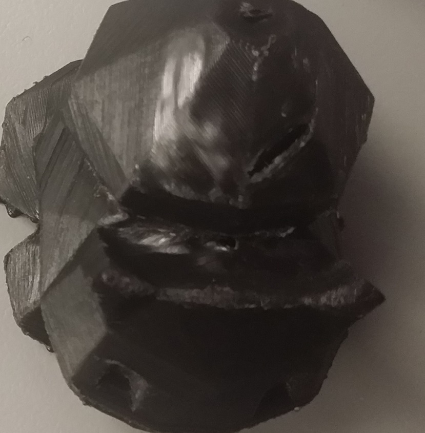

heres two pics I took of what i've done thus far. the left coin was done with .1 layers, at 210 c, figuring the temp was high I tried it at 175 and it came out much worse. could I possibly have the extruder to close to the plate?
the second picture is of a low poly bulbasaur, the bottom was a wreck as i expected due to the overhangs; going back in towards the top it was amazing, then on the bulb it did that; not quite sure what is going on.

well i cant tell if your plate is too close without seeing a picture of the first layer BUT you are most definitely over extruding. you are putting out way too much material. measure your filament and make sure that is entered into the slicer right. if that is correct then you need to lower your multiplier
