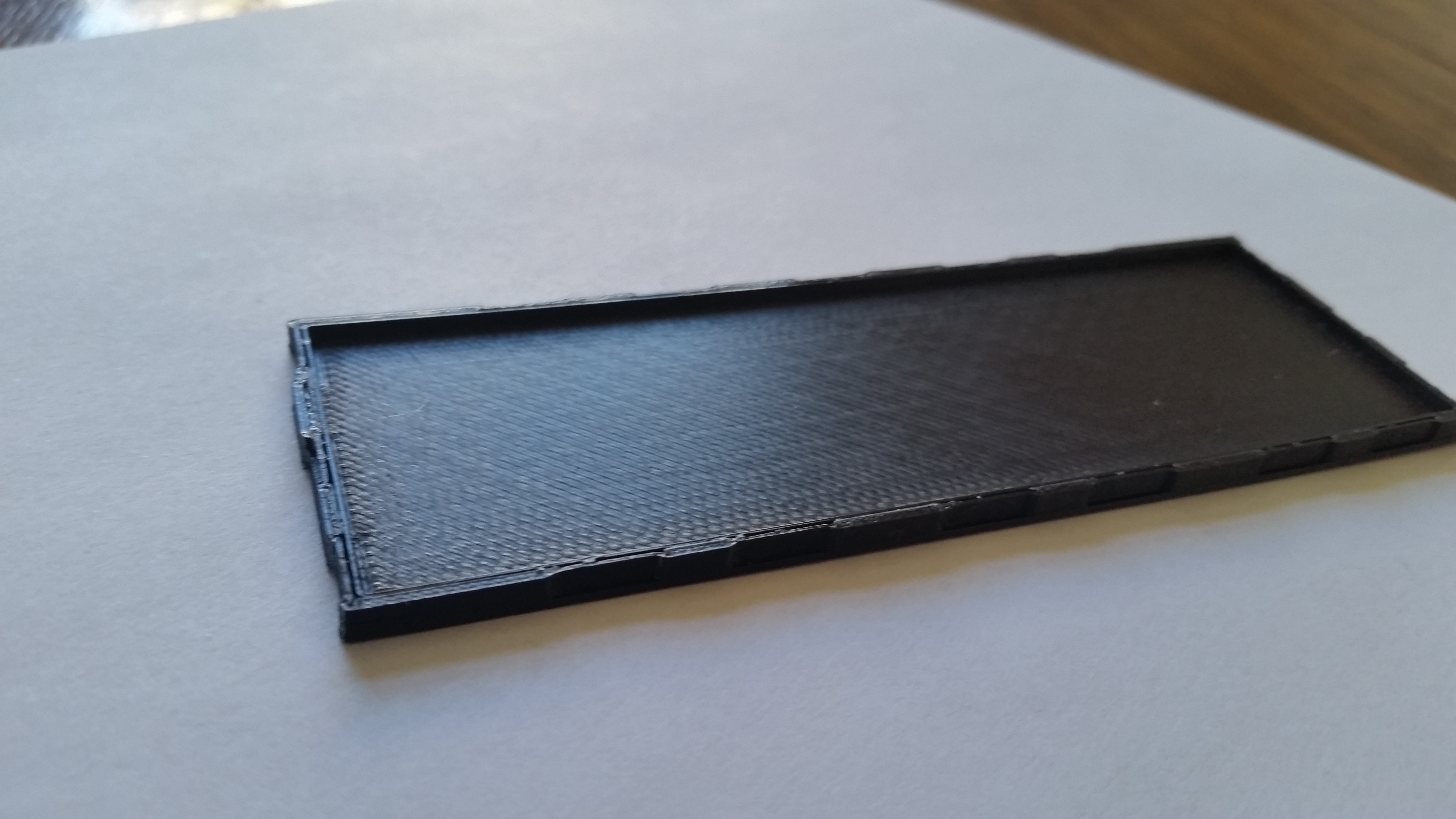

I'm a little confused as to why my models aren't fully printing infill. At one point I was printing them fine w/ infill, but guess somewhere along the way I've messed up the settings.

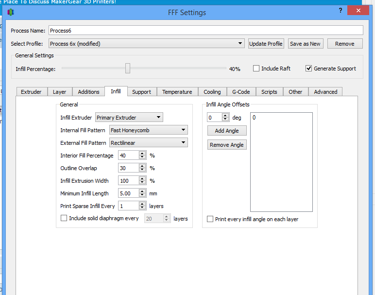

I've attached a screenshot of my infill settings. I want to have infill printed throughout the entire hollow space. It starts to print infill for the first few layers after the base. I tried the honeycomb for the first time on this attached image, but then it goes back over the honeycomb with a solid layer. How can I just have honeycomb all the way throughout the model?
Any help please?
Any help please?

I've also had that last checkbox checked and it did'n't make a difference, the "print infill on every layer"

That top solid layer is not infill, it's a top solid layer. If you want the infill to show (as in the honeycomb is visible on the outside) set your number of top layers to zero.

I may be confused with the lingo here.
I don't see anything called "top solid layer" in the infill settings. Are you referring to the "top solid layer" in the "Layers" Tab?
Just to be clear, this was going to be a building. I stopped the print bc it wasn't printing infill the way I needed it to. It doesn't seem to be printing any infill. It was going to be hollow and the bridging isn't working good enough to close the gap when it gets to the roof of the building. So I had assumed no infill was being printed and this simply printed the "Bottom Solid Layer" which I have set to 3. I have the "Top Solid layer" also set to 3. I had assumed that the "Top solid layer" is referring to the roof area of my building, the top part. So I'm confused as to to what the "top solid layer" has to do w/ my print right now, since I stopped it very early in the process.
I don't want the infill to be visible. I want it for structural purposes inside the model. I just want some kind of infill printed, but none is being printed. What settings can I do to make the infill come back?
Re: Help with infill settings
Yes, the top solid layers are set in the Layers tab.
But you're not wanting infill, you're wanting Support.
The support tab allows you to fill up an empty space when there is nothing underneath a bridging area. Just turn that on and it will automatically generate. (Or you can generate it manually.)
I don't entirely understand what's going on in this thread, but it sounds like there's some confusion between infill and support.
When you design a model, anything on the solid inside of a model will be infilled. In order to print some parts, you may need support, which is like infill that goes on the outside of a model, that is intended to later be removed after the print is finished.
If you model an actual hollow box with thin walls, the interior space on the "inside" is actually outside the model proper, so won't be infilled. If you want a solid box with an infilled interior, you would model it as an actual solid box. If you don't want to do that and fill in the inside anyway, then you need to generate support inside the box which will never be removed.
