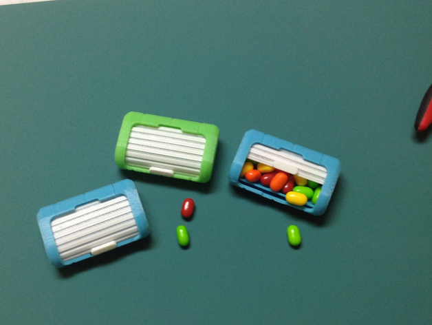

Depends on what you are trying to hold together with it. There's a way to make PLA bend (example of the technique below) but it's not terribly strong. Basically have to keep parts of it at a couple of layers thick.
(The lids on the roll-top boxes)
Might be better off trying one of the flex filaments.
