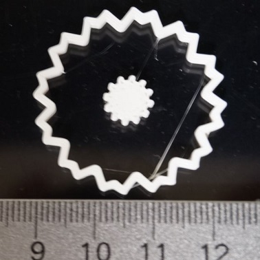

Hi all,
I bought my M2 from Amazon back in January and have been having a blast with it ever since. I have been lurking on the old board and would like to thank all of you because that saved me from lots of headaches and trauma associated with the learning curve. I have been using ABS almost exclusively and am ready to try PET. I am not happy with the shrinkage and warping with the ABS.
Anyway, since I have a new toy, my father has asked me to make him some parts for his model trains that are no longer available. I will attach a few pics of the part. So I drew it up using Sketchup as two pieces. One hollow cylinder and the gear. The diameter of the gear is approximately 7mm and it has 12 teeth. When I tried to print it I realized right away that there is no way I'm going to be able to achieve that kind of resolution with a .35 nozzle. I tried it with telling the slicer that the nozzle was .10 and no luck.
Do I need to buy a .25 nozzle in order to make this part? Is it possible to make parts this small?
Thanks in advance for any advice.
Megan

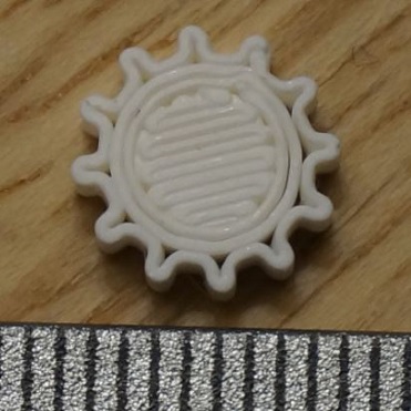

Just for kicks I tried to print a small part like that in PLA. Hard to say if it worked or if it didn't. The print is clean but it's not the exact shape of the CAD model. Here's the model:
And here's the printed part on the bed, with a skirt around it to give the layers a chance to cool while printing. The scale on the ruler is in mm.
Here's a sharper close up showing the printing paths:
It feels stronger than it looks, but the teeth aren't the same shape as the CAD model so it might not function well as a gear.
