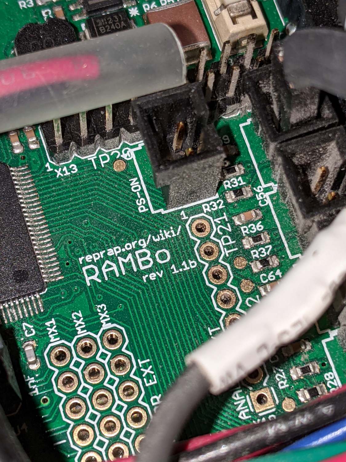

Wisely is it written: Hell hath no fury like that of an unjustified assumption. [grin]
Stipulated, mine is an old old M2, shipped long before MG had any notion of version numbers or serial numbers.
For those reading this in the future, you may safely assume MG shipped printers containing every possible the RAMBo board version.
