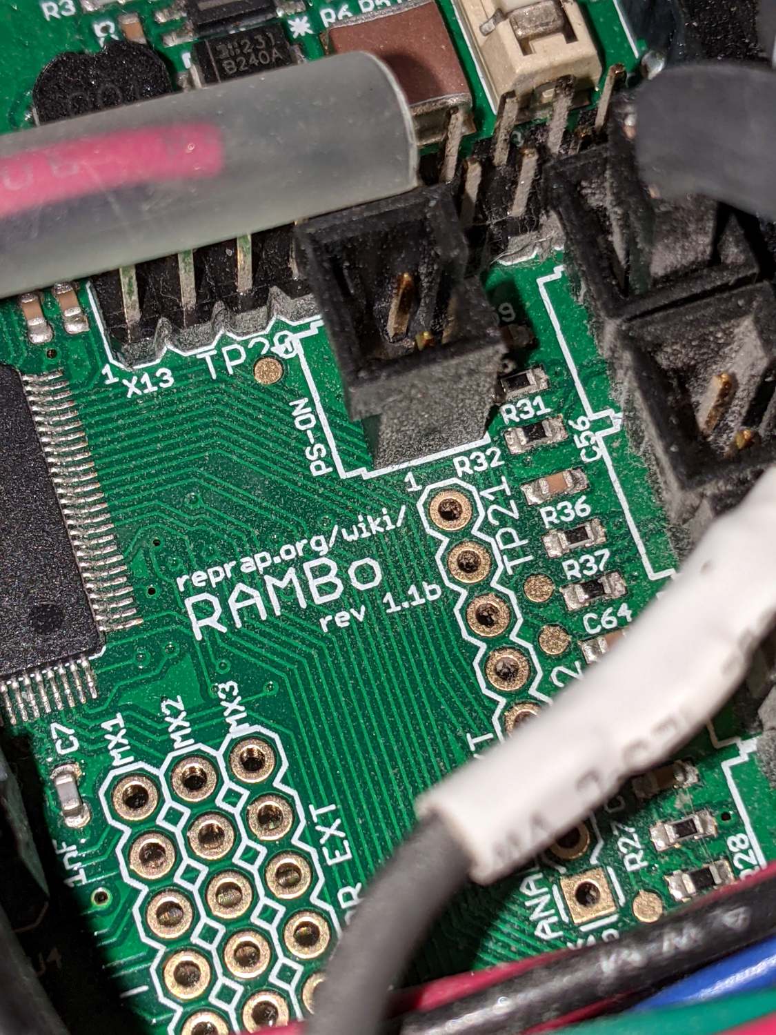

Post by ednisley » Sun Aug 29, 2021 2:42 pm
The board has a version legend somewhere near the MEGA chip telling you the revision.

Post by ednisley » Tue Aug 31, 2021 5:18 pm
Gwhite wrote:
Tue Aug 31, 2021 12:07 am
MakerGear is using RAMBo Version 1.4 boards
Wisely is it written: Hell hath no fury like that of an unjustified assumption. [grin]
Stipulated, mine is an old old M2, shipped long before MG had any notion of version numbers or serial numbers.
For those reading this in the future, you may safely assume MG shipped printers containing every possible the RAMBo board version.
