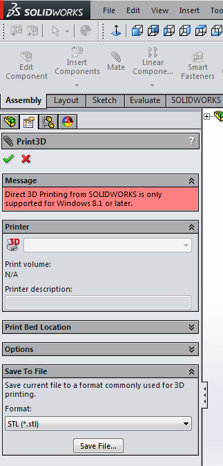

I'm a big SolidWorks user as well and was wondering the same thing when I got my printer a year ago. So far the M2 doesn't seem to work with SW, even in the new 2015 release. When I select File -> Print3D the feature manager tree pops up, but it says that direct 3D printing from SW is only available for Windows 8.1 or later (I have Windows 7). Also, I haven't been able to get it to recognize that the M2 is connected to my computer (didn't recognize it as a 3D printer, etc.)
Here's a video that seems to show SW Print3D working pretty well though, at least with SW2015, Windows 8.1, and a Makerbot... http://www.youtube.com/watch?v=ilkXh3ryBGU
So, I'd imagine that eventually SW will be able to run the M2. But for now it's questionable at best. If you do have SW2015 and Windows 8.1 I'd be curious to hear if you make any progress with it.
As others have said I'd recommend Simplify3D (or Slic3r if you don't want to shell out the additional money for S3D). Even if you could get it to work in SW, the printing options available there look very limited. S3D (and to a slightly lesser extent, Slic3r) allows you to manipulate tons and tons of settings so that you can tweak things to improve bed adhesion, print quality, etc. As you become more experienced with your M2 you will want this flexibility.
