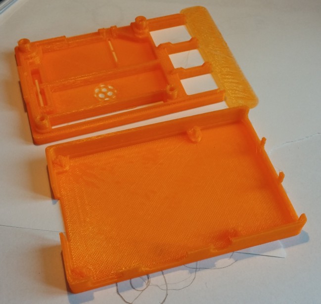

I have my M2 for some months and in general I'm quite happy with it. After running out of MakerGear filament I ordered a couple of rolls of PLA in different colors (the brand is NuNus). I would buy makergear filament but as I'm based in Europe shipping is quite expensive (in terms of money, time, environment,...). With this new filament I get quite bad results (see pictures).
(557.78 KiB) Downloaded 955 times
(320.29 KiB) Downloaded 955 times
I'm wondering whether I just haven't found the right settings for the new plastic (I tried a lot) or whether its quality is just bad. Compared to MakerGear PLA it seems to be more viscous.
I'd appreciate your thoughts!

I forgot to mention that the problem varies from roll to roll. Using the same setting, e.g., the roll of transparent PLA performs much better than the gray one that you can see in the pictures.

thanks for your answer! I just tried another print at higher temperature but the problem remains (see picture).
I also experimented a lot with different temperatures to solve the issue before, but it never really helped.
I also think that first layer adhesion is not the core of the problem. My guess was either overextrusion or underextrusion: it is weird, sometimes there seems to be too much filament - especially for the first layer - such that it piles up to chunks. Then, the nozzle runs into these chunks and spreads them around. On the other hand, sometimes the lines seem too thin or even missing.

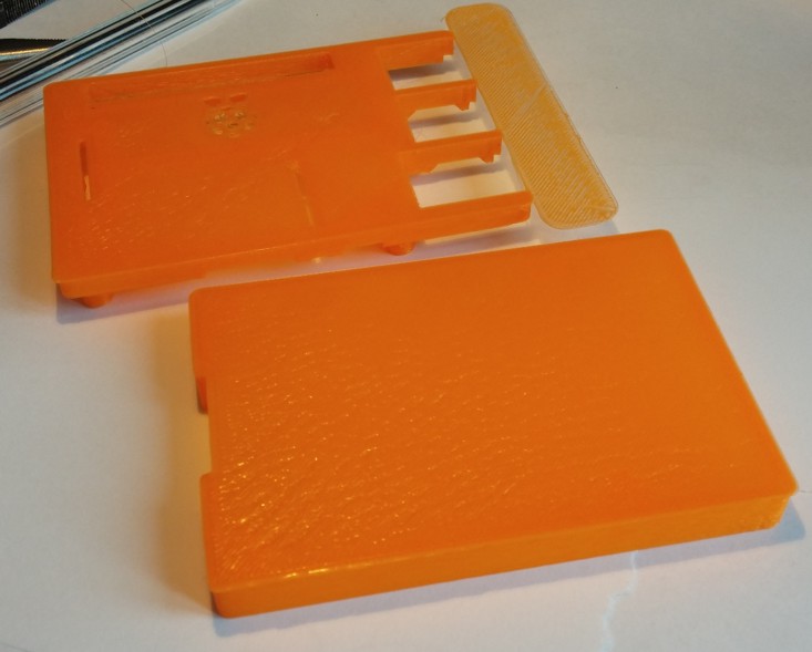

After checking the bed leveling which seems ok, I followed jsc's advise for adjusting the extrusion multiplier.
I started at 70% as suggested which turned out not to be too unreasonable after all. Strangely, at 70% the print was much better -so I let it finish at this value.
The first layer still suffers from the incorporation of some of the chunks described above as you can see here:
Nevertheless, the rest seems ok:
Now I'm wondering whether my settings are messed up or whether something is wrong with my nozzle (as 70% seems to be a big deviation from the standard value).

Re: Bad filament or bad settings?
Post by jsc » Sun Jul 27, 2014 5:24 pm
If 70% works for the first layer, perhaps your first layer z height is too low?
Try a print at a more usual extrusion multiplier (90-95%), but for the first layer, try clicking the Z screw knob counter clockwise one click when the skirt is going down. That will increase the layer height. If the first layer goes down okay, let it print for two or three additional layers to make sure you're not getting issues. If it looks good, then adjust your Z height screw appropriately.
