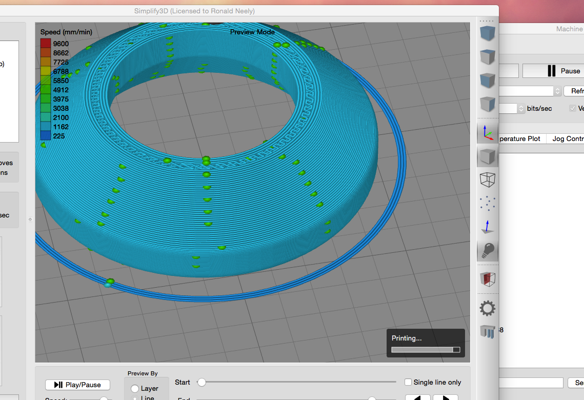

Made adjustments but I am still having some retraction issues. here is the print preview showing where they appear on the printed part.
the retractions appear exactly as it appears in the preview

i have not had good luck with retracting ninjaflex at all. as insta said you can snap it back real quick at something high like 5-6mm but the stuff really just stretches like a rubber band so is only pulling it back just a little down in the nozzle. once it has retracted a little then i find it wont begin printing right away at the start of a line because it just compresses and wont start extruding right away when it returns from the retraction. it certainly doesn't work on every model but i try to avoid retractions whenever possible or dont spread them all over the model. set them to be all in one line like a seam then you can easily razor blade the bumps off when done or even take a soldering iron on low temp and smooth the bumps out.

Thanks Jim, I have increased my X/Y to 18000.oo and it seams to have made it better, at least far less bumps. It is some tough stuff to run. Trying to make Skin brakes and it looks promising.

jimc wrote:i have not had good luck with retracting ninjaflex at all. as insta said you can snap it back real quick at something high like 5-6mm but the stuff really just stretches like a rubber band so is only pulling it back just a little down in the nozzle. once it has retracted a little then i find it wont begin printing right away at the start of a line because it just compresses and wont start extruding right away when it returns from the retraction. it certainly doesn't work on every model but i try to avoid retractions whenever possible or dont spread them all over the model. set them to be all in one line like a seam then you can easily razor blade the bumps off when done or even take a soldering iron on low temp and smooth the bumps out.
Thanks Jim part looks much better when I put them in one line. A lot easier to clean up.
