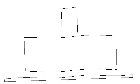

I use my machine for some manufacturing prototyping where accuracy of the print is the key. I will typically print an item
and good stable settings measure it adjust the model and reprint at the same settings to get it exactly right.
This works well for me.

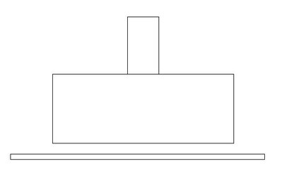

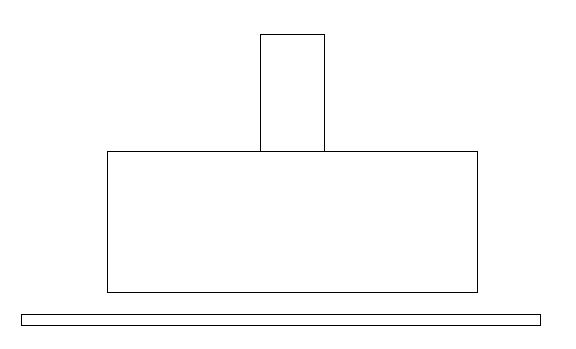

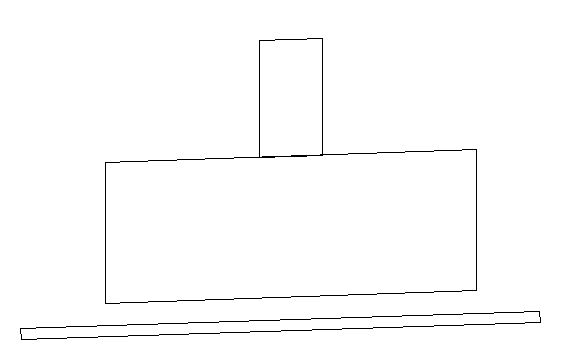

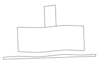

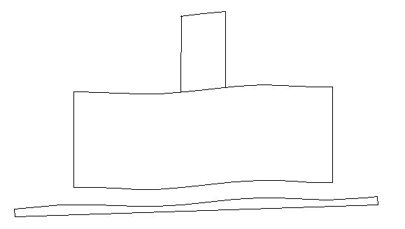

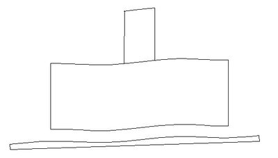

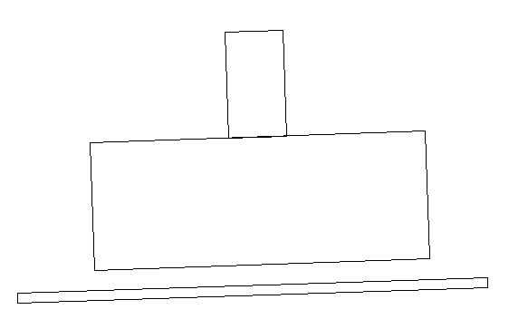

I am attaching some pictures to illustrate what I am talking about. In the bottom of each picture the lower area represents the build plane and the
upper item would be the part as it is printed on that plane. A gap was left for visual clarity.
In a completely flat setup with the bed perfectly level the perpendicularity of the sides and the z planes is quite good
With the plane style of auto leveling you probe the table and the software creates a best fit plane from the probed points.
What I am unclear on is how this is applied. From an accuracy standpoint it would be best if the entire plane was rotated and every X Y & Z
was recalculated on every layer this would result in a part with perpendicular sides.
What I am hoping they don't do is correct for the z-plane and leave the X & Y axis alone what this would result in is a part that the
tops and bottoms are perpendicular to the virtual plane and the sides are straight to the z-Axis.
I am completely lost when it comes to the mesh leveling. I get that is creates a map of the bed and it would allow the first layer to be
super accurate to the un even surface . But what happens to all the layers on top? does it try to create a tiled plane for the sides?
Or does it just map the bottoms and tops and leave the sides straight?
Some questions on this is the top layer uneven like the base plate?
Is there a way to have it mesh level the z plane and absorb the variations in to the first few layers?
It seems to me the most accurate way would be the plane level if at actually adjusts the X,Y & Z.
I know if you are doing small or short files this wont be a problem bit for taller files it can really make a difference.
