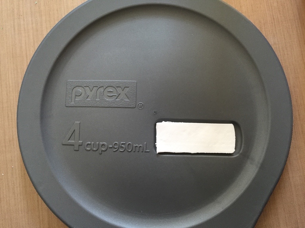

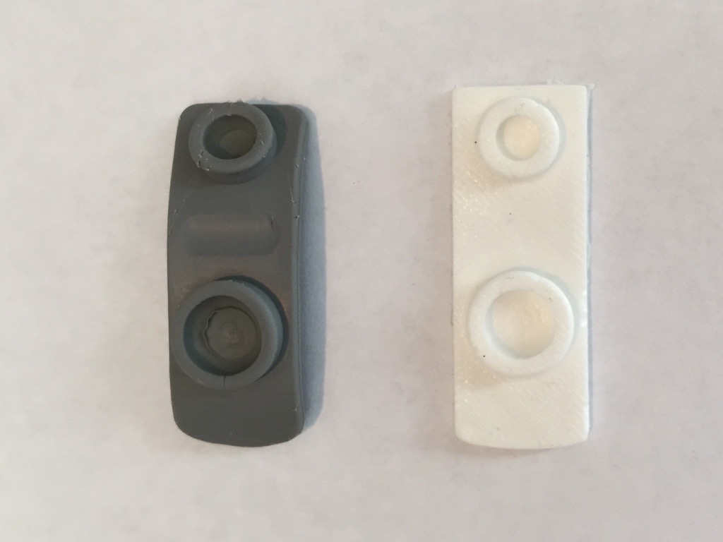

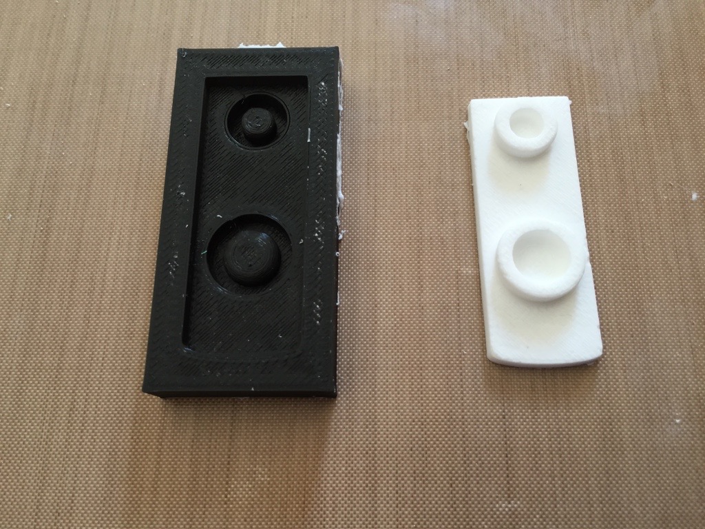

Needed some flexible rubber lid vent plugs for some Pyrex food containers. You can't just buy the plugs, or even the lids separately. I printed a mold and stuffed it with oogoo (silicone caulk with a dash of corn starch to speed up curing). Works great.
I didn't have any corn starch; rice flour worked fine as a replacement. I think any hygroscopic fine powder will do.
From Home Depot:
GE All Purpose Silicone I 100% silicone is compliant for incidental food contact under FDA 21 CFR177.2600 "Rubber articles intended for repeated use."

No mold release.
I had originally made a mold from the original with an epoxy resin. The first cast was less than perfect, but it released. The second would not release and the mold was unsalvageable. So I resolved to print a mold instead. Silicone doesn't stick to PLA.

jsc wrote:......Silicone doesn't stick to PLA.
That is great to know.....I did some mold work years ago, and the worst thing was to forget to spray it before you poured! (Wound up having to rebuild a bunch of molds.) I'd wondered about using the resins - I've still got a lot of it. But it is messy to work with, I'd much rather print them if they work that well.
