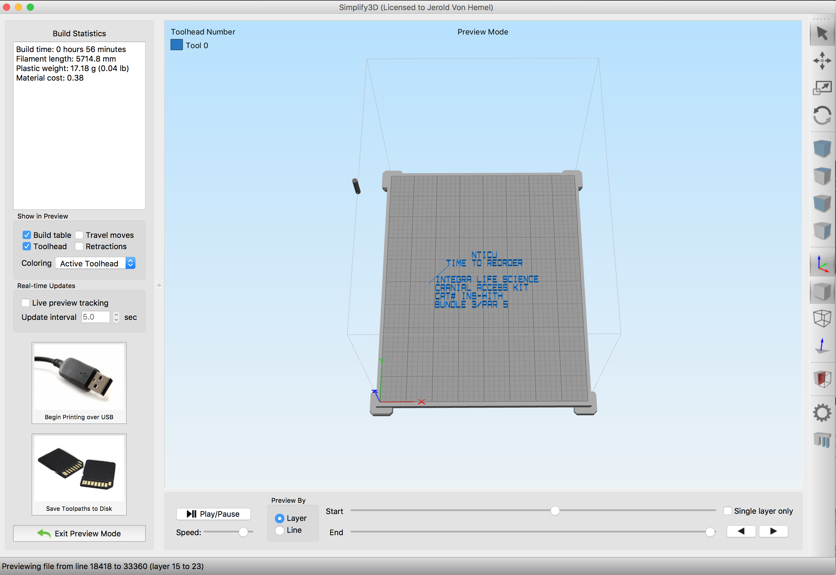

My problem is finding the correct layer to apply the code to. I initially used S3D and identified Layer 15 where only embossed letters are printing, then added the appropriate code snipped. The first print attempt paused earlier than I wanted and printed part of the shell in the new color.

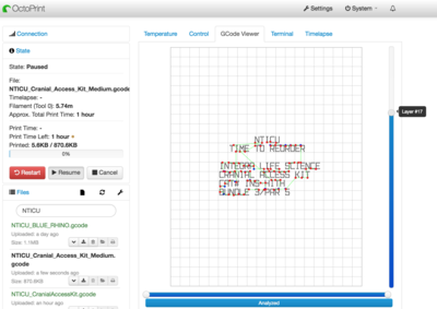

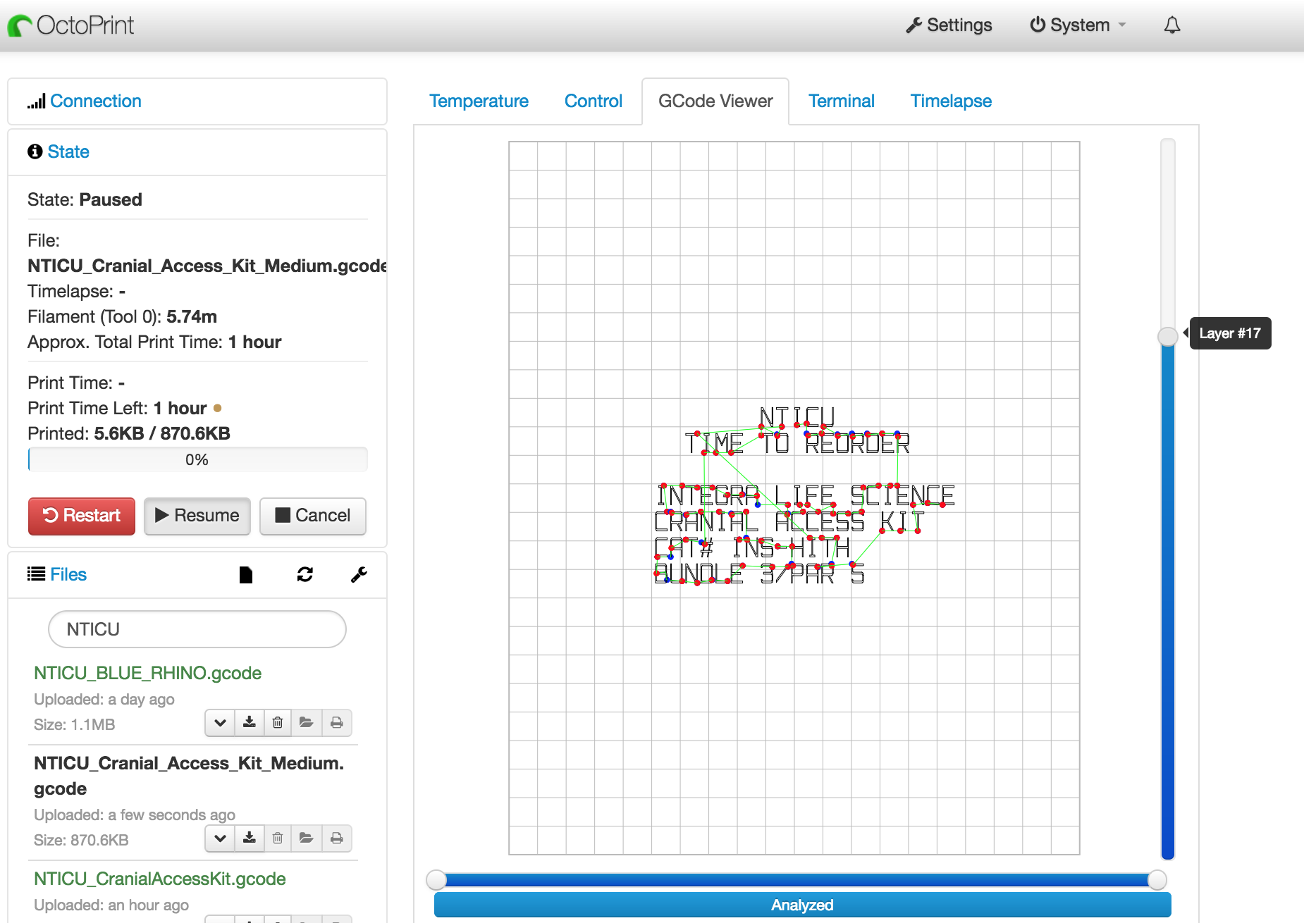

I looked at the layers in Octoprint and the same layer reads Layer 17, which is the correct layer to change filament at.

I think I may have figured this out. Looks like S3D starts the count at 0, where Octoprint starts at 1. I looked at it again in S3D and isolated the start/end of my desired layer. Looks like the actual layer in Octoprint is the S3D second number plus 1
