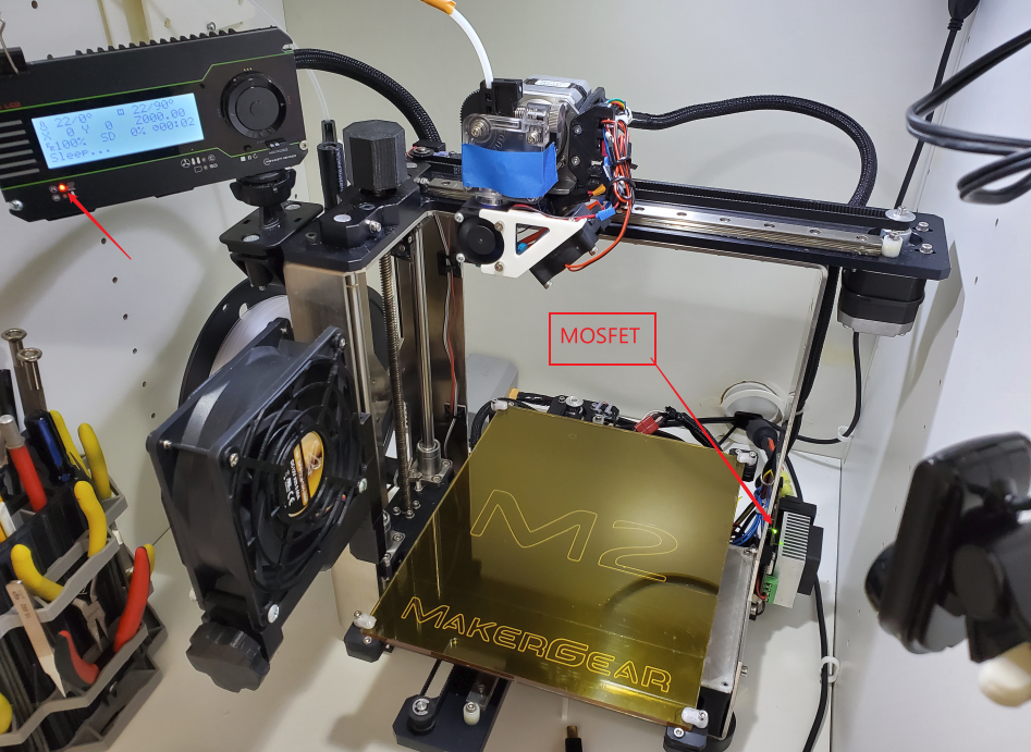

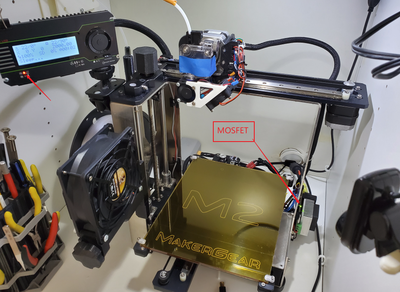

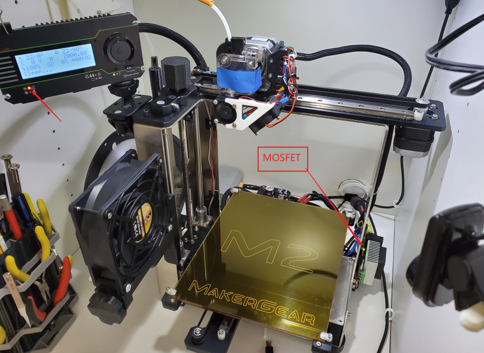

It died during a 16 hours PETG print job with 90C heat bed. Based on the look of the print, it stopped heating early stage of the print job. This is the 3rd time it has stopped working on me. Previous two incidents were involving printing ABS and power connector melted.
I've added a big MOSFET after the last incident. There is no melting connector this time, and heat bed LED indictors (on viki LCD and MOSFET) turn on when heating command is sent (via Proterface USB and SD). The original 12v PSU brick's LED is on as well, but the bed just doesn't heat up at all.
I'm clueless as what went wrong this time. Any suggestions would be appreciated.

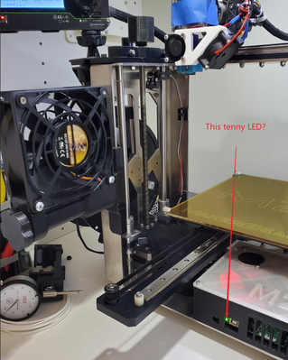

All those LEDs show the low-current control path works fine, but I'm reasonably sure the teeny LED on the front of the platform isn't glowing, so the high-current path is broken.
That little green LED is on while heat bed command is sent.
Mmmmm, my remembery has failed.
I thought there was an LED on the edge of the platform, connected in parallel with the heater power. That's not what you have, alas.
Turn the power off, unplug the heater connector at the platform, and measure the heater resistance. If it's more than a few ohms, there's your problem.
