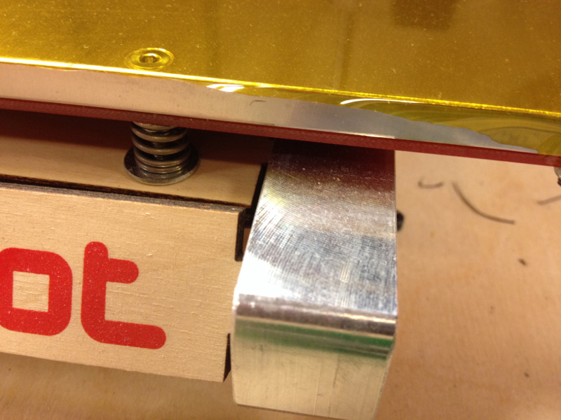

as promised, here is a pic of my mb with the 1/4" cast aluminum tooling plate.
other mods you can see in the pic are the milled 6061 aluminum arms that replaced the plastic ones, and heftier hbp springs.
additional mods are 6061 milled aluminum filament block, and some custom bearing rod holders.
whole thing is weighed down with 20lbs of additional weight on the top to keep it from walking around at my normal build speeds (remember its made of wood)..
mg modified
image (2)-800.jpg (131.61 KiB) Viewed 14663 times

innkeeper wrote:a pic of my mb
Ahhh, that laser-cut plywood stirs up the memory pond's silt...
