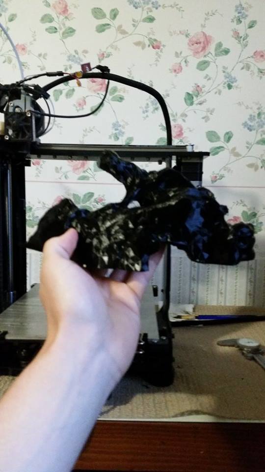

My first big print with the black!
Roughly 70mm/sec
.88 extrusion multiplier
bed at 90°C with Garnier Fructis Extreme hairspray
Extruder at 250°C
20% infill
140% infill extrusion width
Ran for about 11 hours.
Came out great, with zero warp.
right sabre skull.jpg (54.38 KiB) Viewed 16061 times

Slipshine wrote:I would try it again same settings but use support this time. That should fix it.
I printed it with support, like I said it came out really well, nothing to be fixed.
I don't know what you meant by that.
It's a portion of a low-poly sabre-tootheded tiger's skull.

I looked at it when you posted and just didnt reply because i wasnt sure if it was supposed to look like that or you were being sarcastic and it was a big blob mess. Lol. You really cant tell from the pic.

jimc wrote:I looked at it when you posted and just didnt reply because i wasnt sure if it was supposed to look like that or you were being sarcastic and it was a big blob mess. Lol. You really cant tell from the pic.
Haha it does look like a blob. I guess the photo was just to show the size. It spanned almost the length of diagonal bed corners.
I was just really happy with the zero warp after printing it once in ABS and having over 1/4" lift in the corner.
