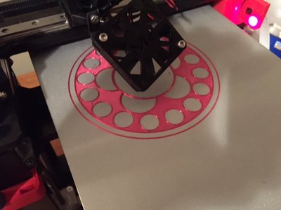

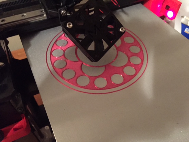

I've been trying to print this splash spool remix I did, and it's been giving me trouble due to PETG strings getting caught up...
I took your FFF file and made the adjustments you recommended and so far so good...take a look....I can't say if the entire part will come out successful, but so far so good!

no problem. the thing with petg is that it will not tolerate ANY over extrusion. as jules said its very sticky. when abs is overextruded a little the excess filament just squishes out to the sides. with petg because its so sticky, any extra over extruded plastic sticks and accumulates on the nozzle. stringing or fine hairs on petg made during travel moves is normal but can be almost eliminated by lowering the temp a little and making sure your not over extruding. the trick is getting petg to print at a temp that is low enough to eliminate the strings yes not so low that you have poor layer adhesion. this is usually a very fine line of about 5 deg.
Yes in the bad prints I could see the strings cross areas and drag things around at times...The current print with your settings are still working! I may try to print my kids duck again and see if that comes out better as well with these settings..

Both the spool attachment and another duck printed...both came out great!!

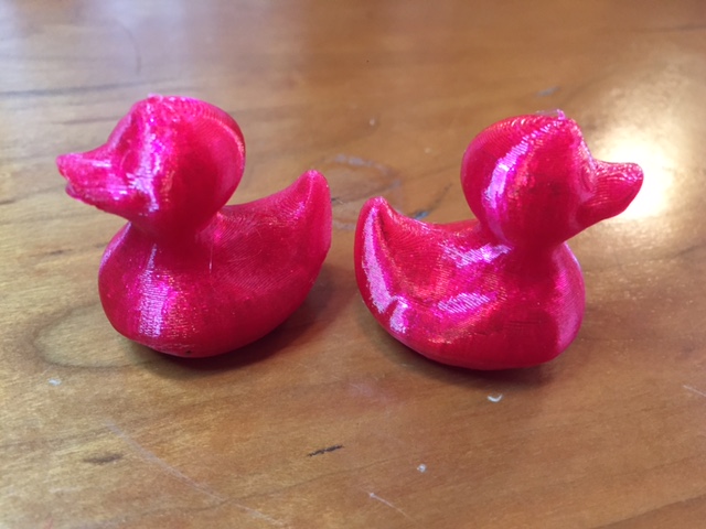

Here are the ducks printed in PETG...
The left duck is printed with JimC's FFF file with the nozzle set to .35, the right is .40...My nozzle is .35 (v4)...
I do notice the right one has a bit more of a irridescent look to it....I'm not sure if that's good or bad...
I think I like the .40 setting, though I'm not sure if that will ultimately mess something up...

The extrusion width can be anything from the actual nozzle exit diameter up to the width of the flat of the nozzle. So, from .35 to ~.50mm. In practice, it is best to avoid either extreme because you will get some spread so it is difficult to get exactly .35mm widths and it's difficult to know what the actual max extrusion width is. 0.4mm is a good choice because it is a) bigger than .35 and less than .50, and b) as a round number it is easy to design thin features to fit an integral number of perimeters.
