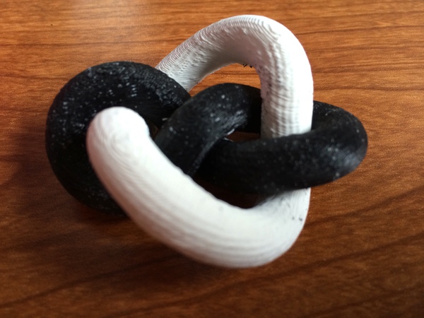

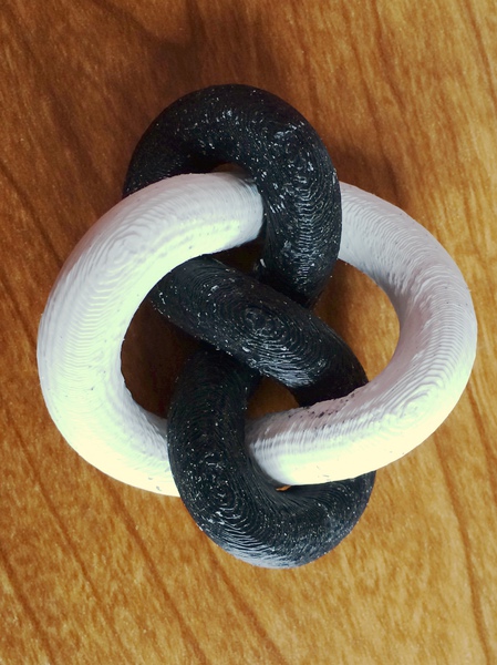

Another dual extruder test. I would not count this as a success, since the bottom has lots of threads of the wrong color embedded in the layers from the support, but it looks okay from the top. I used the ooze shield for this, which was insanely hard to remove, but with a retraction of 16mm, it may not be necessary.

That turned out nice.
