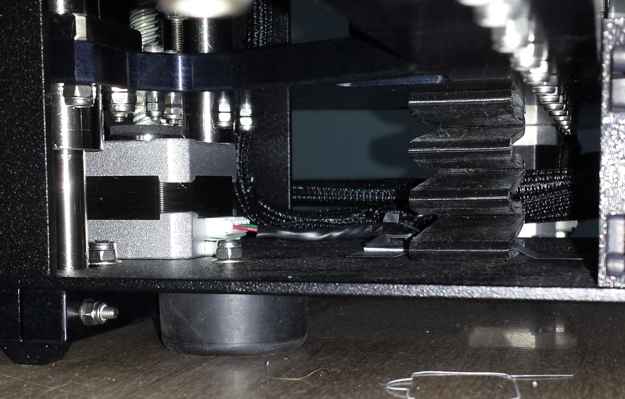

I finished printing this PLA "spring" which, when testing is complete, will keep the Z Axis/Bed from hitting the motor when the motor's disabled. I'm also hoping that the spring's position under the bed frame will remove some of the "bending" tension that occurs from having the weight of the bed and bed heater so far from the Z axis screw and rods. Might just be my own perception, but it can't hurt. :D
Sorry for the poor picture quality.
The Spring taped in place
(241.68 KiB) Downloaded 1043 times

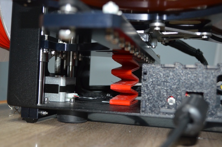

This pic shows the bed dropped onto the spring, leaving a small gap between the motor and bed frame. When I dis-engaged the motors, the bed had my cell phone on it to simulate a printed project's weight.
The Spring in use
I may have to revise the design as some of the sections have split along the long axis. Testing will continue ... :)

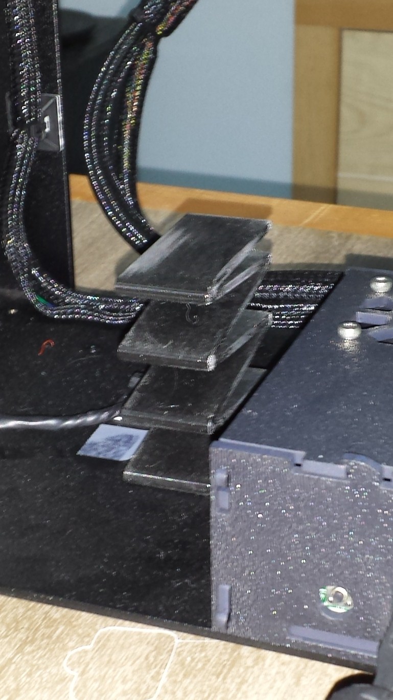

Revision B off the printer
Post by Mike Hunter » Tue Dec 02, 2014 9:53 pm
Afternoon:

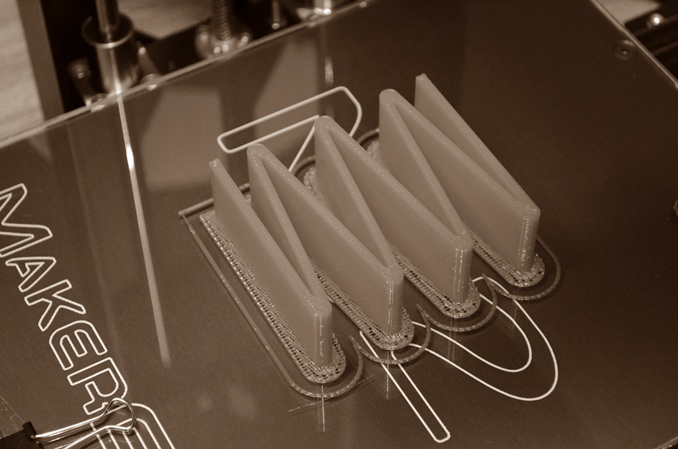

I just finished printing the Rev B spring and it looks like it'll work a bit better than Rev A.
The finished print before separation. The lack of color makes it easier to see the red filament
I placed it on the machine and ran a couple of "drop" tests using an empty glass and my cellphone as (simulated) weight. Looks like it'll keep the bed higher than Rev A and the splitting hasn't appeared yet.
In place and working as planned ... so far
I'll attach the "factory" file for those using S3D, the .stl file and a .txt file with the S3D parameters for those not using S3D.
Well, apparently I need to revisit the procedure for attaching files other than .jpg as I keep getting a "The extension ... is not allowed". It bombed for both the .stl and the factory file. I'll get those up as soon as I can.

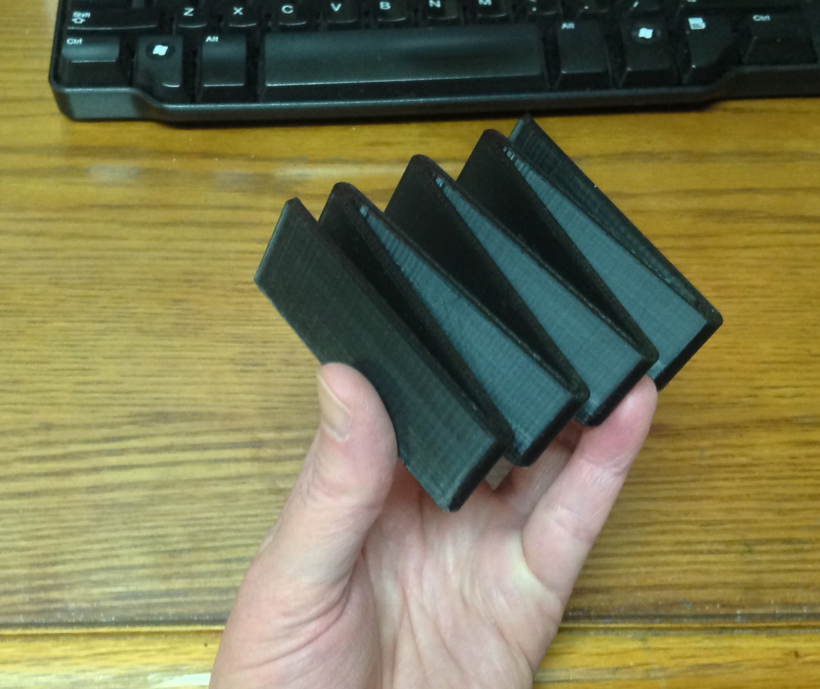

Re: A Bed Spring
Post by Jules » Tue Mar 03, 2015 4:40 pm
This thing is pure-D-spectacular Mike! It was the second thing I printed, after the Z-axis wrench set, and now I don't have to dart across the room to catch the bed when it drops! (Don't know how to modify G-code yet.)
(1014.7 KiB) Downloaded 565 times
I printed it using the settings below. (Picked it up off Thingiverse instead of seeing your zip here with the S3D settings. Really wish I'd seen your S3D code. :roll: )
PLA, 218°/0°, 3 perimeter layers, 50% infill, and because i was already having trouble with the PLA warping a bit and I wanted this to print perfectly flat....a 3-layer brim - 10 wide on hairsprayed glass.
Now let me warn other beginners about what NOT to do......never, under any circumstances, use a 3 layer brim on your print, unless you want to spend as much time carefully carving it away as it did to print the object in the first place! (Oh well, it did stick to the bed.) :lol:
I attached it to the bed with Terrifically Tacky tape (red liner) and it really delivers! Many thanks!
