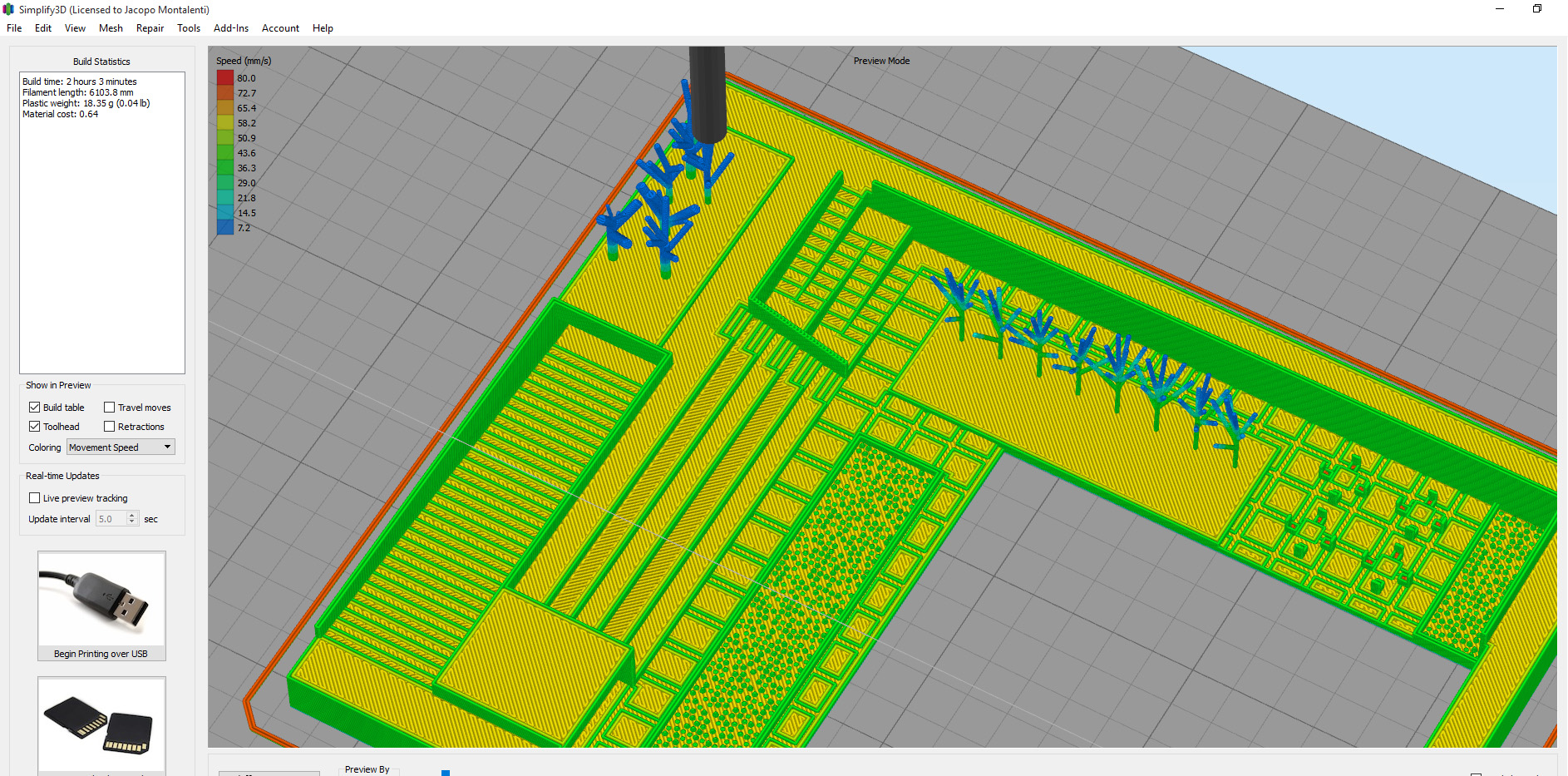

i ended up doing them myself i was wondering if someone has any cool idea for trees
here is the picture of what i modeled
trees
(912.7 KiB) Downloaded 63 times

Those are, alas, probably not printable individually and definitely not in the groups you've shown: they're too small with perilous overhang. The nozzle will collide with the branch tips and knock them down, one by one.
The Thingiverse trees use an algorithm that tapers them from base to tip and produces chunky branches with gradual angles. Judging from the pictures, they're also much, much, much larger than the ones you want:
http://www.thingiverse.com/make:111722
As a rule of thumb, you can't print object features less than a few millimeters in diameter. Near-horizontal "wires" similar to your tree branches tend to curl as successive layers of plastic cool, producing poor results.
Tiny objects and 3D printing don't mix well; perhaps your layouts could have holes for standard architectural model trees?

yes of course i could just leave the hole i was just wondering how it would look with this type of tree
