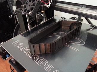

This is my first print with the M2. ( Tracks for model ) Very happy with the printer so far.
My concern is that during the printing process there was a ticking noise coming from the extruder area. It sounds like the fan blades just nicking the fan enclosure. (fast ticking noise, but it only does it when it is doing the 100% infill on the first and last 3 layers of the print.
I am using a V4 hot end with pla filament. Simplify 3d
Print temperatures:
Extruder 215 heat bed 70
I purchased my printer pre assembled.
If the tension on the filament is to little will it sound like fast ticking if the drive gear is spinning out on the filament?
Any suggestions would be appreciated. I just don't want to ruin anything by keeping on printing.
