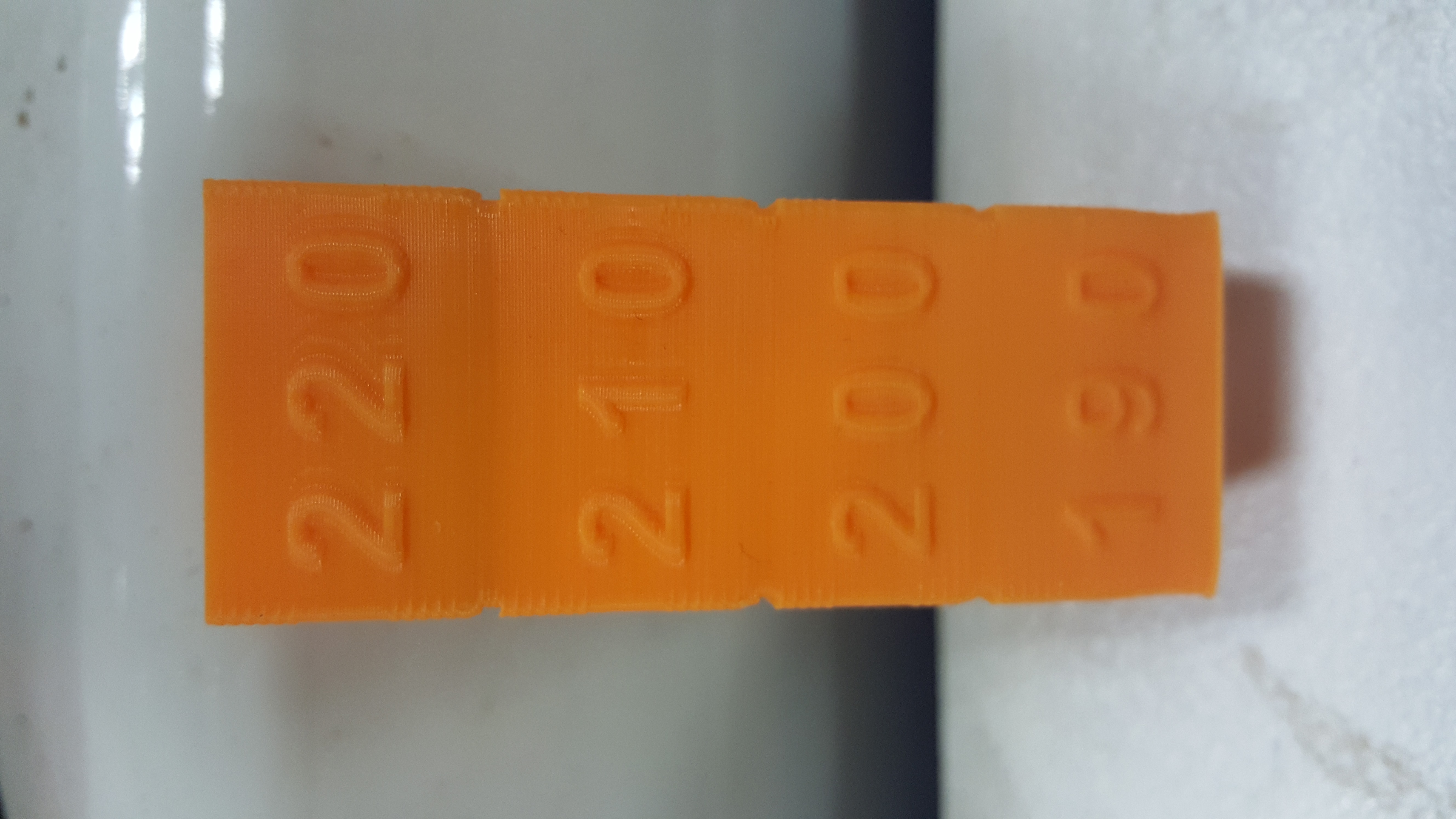

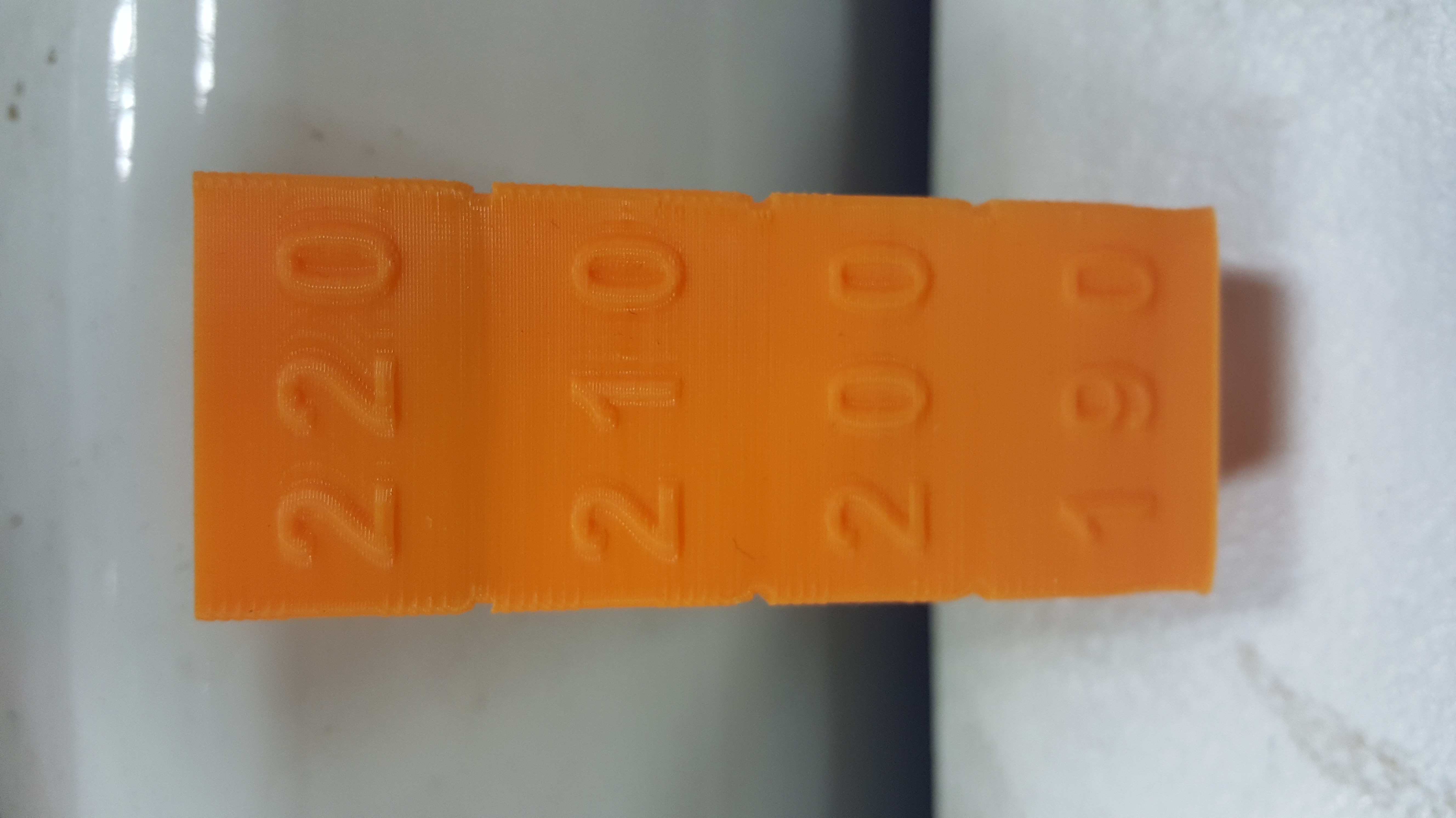

Too true.....How'd the temp blocks come out? (Now you've got me quite curious, and that's a dangerous thing.... :lol:)

Shinier as temp goes up. Hard to tell by these photos though.
