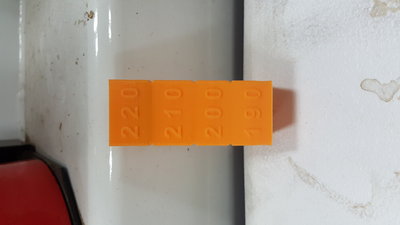

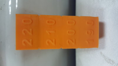

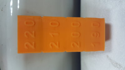

Too true.....How'd the temp blocks come out? (Now you've got me quite curious, and that's a dangerous thing....PcS wrote:Until you get.your z off set ...layer height ....and bed level spot on ....no amount of advice will help.

Shinier as temp goes up. Hard to tell by these photos though.
